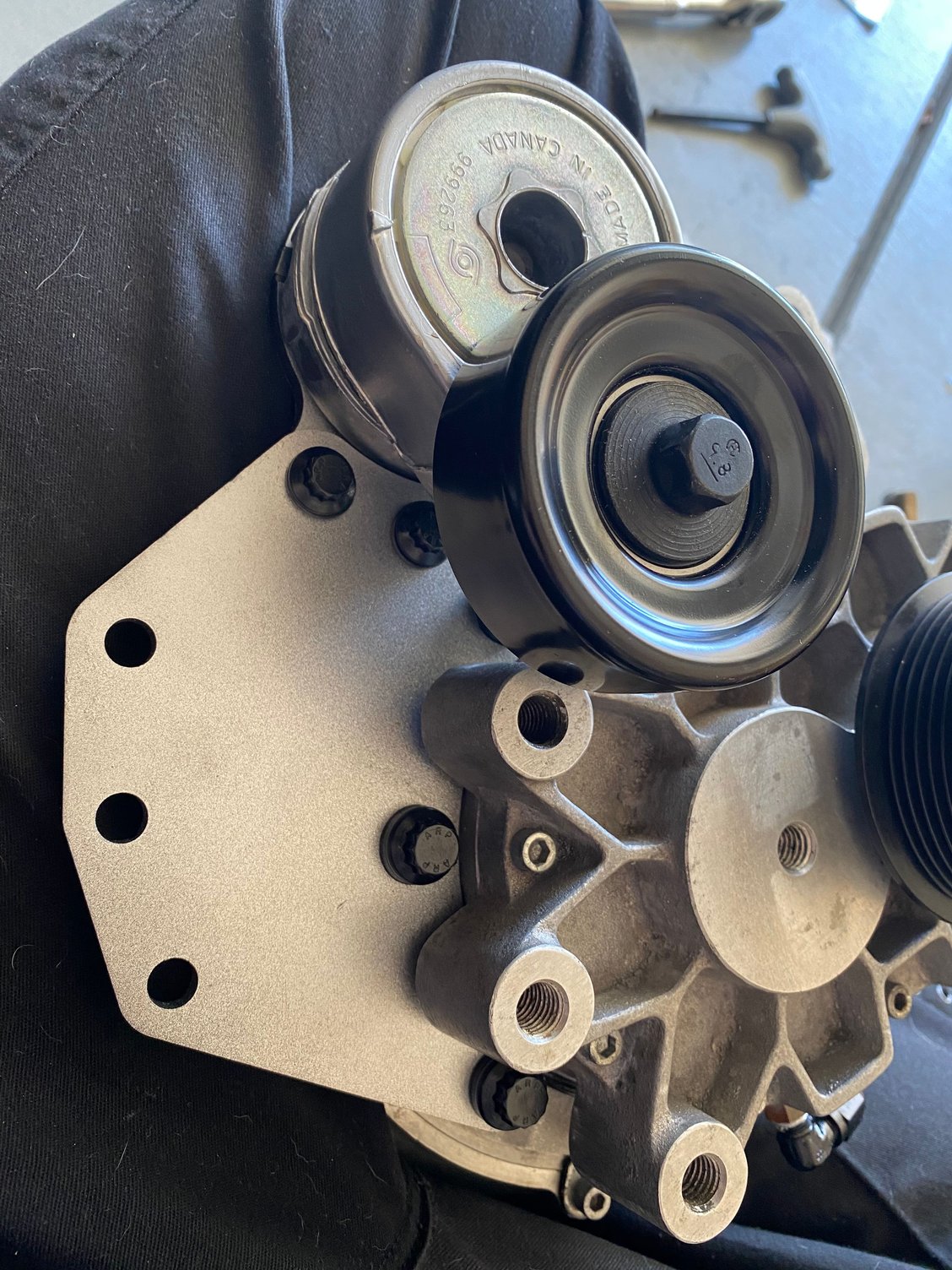

Yes, 8 rib pulleys. I believe this kit has already had the tensioner clocked.
Rear of the tensioner
New tensioner and a little shine
