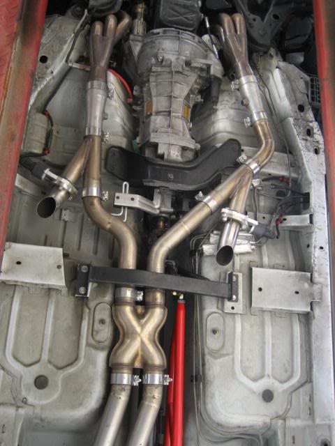

Those are just universal fit x pipes. What I had to do for true duals is get summit 3in x-pipe kit,1 45 degree bend, 1 90 bend, 2 flanges to bolt up to the headers. The problem is on the pass side where it goes around the trans crossmember. That is where I had to use the 45 and the 90. Lots of cutting and welding to tuck up there nicely. I know its not stainless but its cheaper with this kit. Also i had to use 1 of the bends for the turndowns after the bullets.

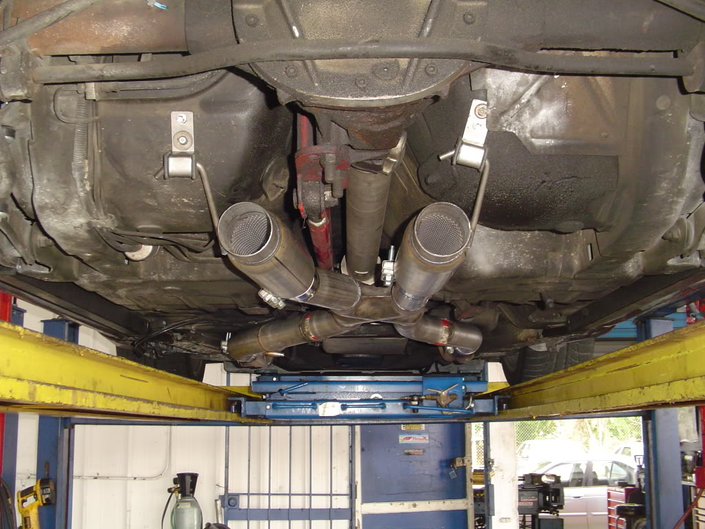

From: Orlando,Fl
I just bought four 45*mandrel bends, one Magnaflow True X-Crossover and two Dynomax Race Bullets for my true duals. My setup is full 3" true duals, I get compliment after compliment from car guys/girls, especially mustang guys. Everyone loves that my car just doesn't sound like a Camaro.

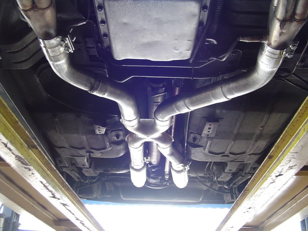

I am using the Magnaflow Tru-x:
