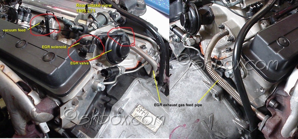

ok here's what im asking, im going to block off and remove the EGR valve, and the EGR exhaust gas feed pipe, which vacuum hoses do i plug up. i circled them...

Old Aug 1, 2012 | 12:03 AM
Posts: 71,116
Re: Post header install questions, need some advice
Hard to believe you can't understand it the way I already explained it.
If you choose to delete the vacuum system, unhook both the vacuum lines, and plug the nipple on the intake manifold with a vacuum cap.
What part of this is unclear..... THERE ARE TWO VACUUM LINES IN THE PHOTO. REMOVE BOTH VACUUM LINES. PUT A VACUUM CAP ON THE NIPPLE ON THE INTAKE MANIFOLD TO SEAL IT. DONE.

I just wanted to make sure i was doing it right because ive never touched anything on the egr and its not really easy to get to and look at for myself. and all the searching ive done, no ones really clear about removing the vacum lines and what size vacum cap you need to plug the nipple, but i get it now. just wanted to make sure i was doing it right
