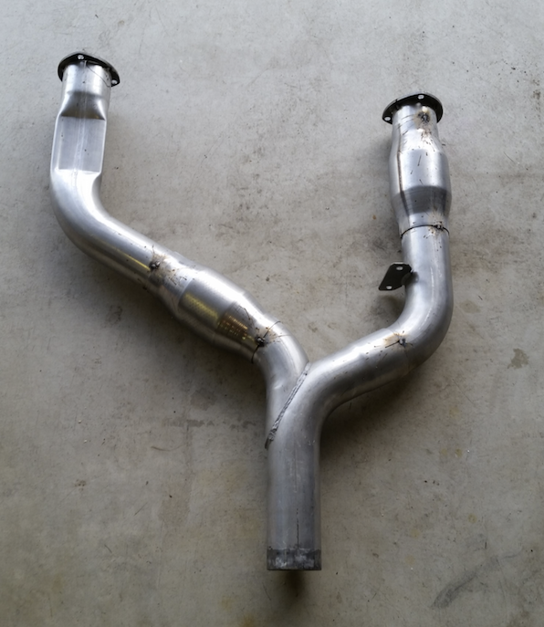

Y Pipe looking top down (before joints were welded).

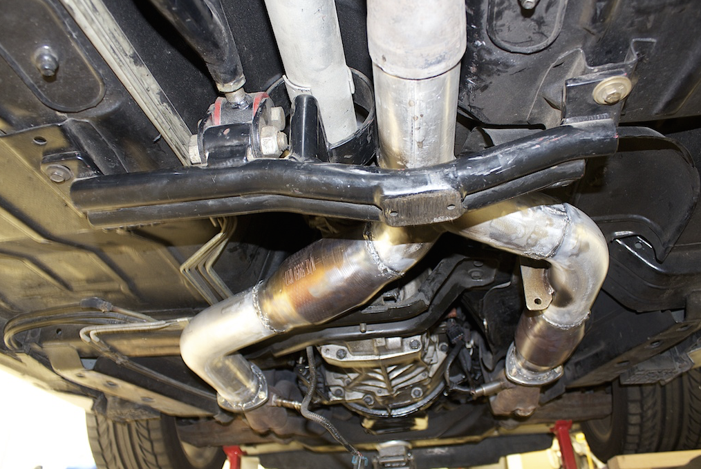

Y Pipe installed from rear.
