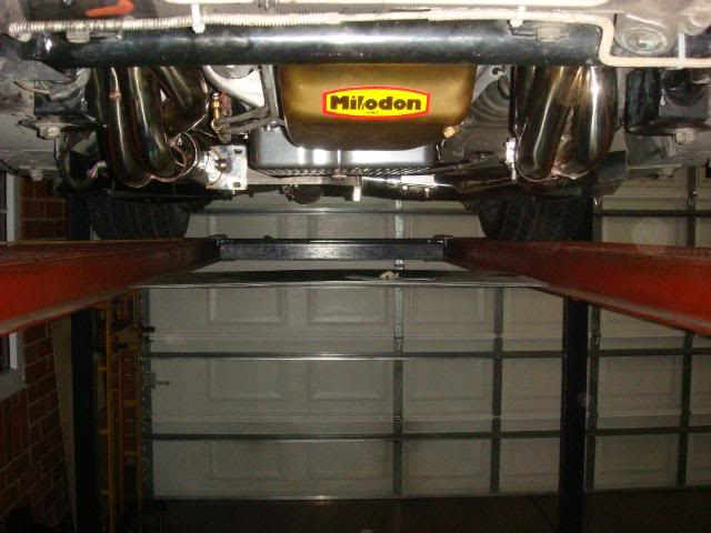

ive been looking at the LPPs but ive got a couple questions.
how is the ground clearance? ive got sportlines...
how is the plug access and wire clearance? do i have to do the OVC wires?

Ground clearance is OK, a little better than the HOOKER super competition.

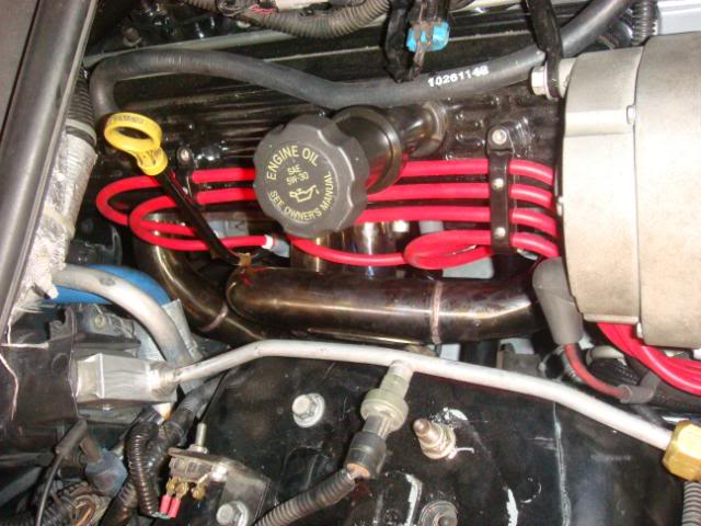

Plug access and bolt access is great.
I dont know if you could go without doing the OVC wires. I've alays done it in my Camaros.
Driver side
Pass side:

those look bad *** man!!! what wires do you use?
how was the install? straight forward from the bottom?
thanks man....

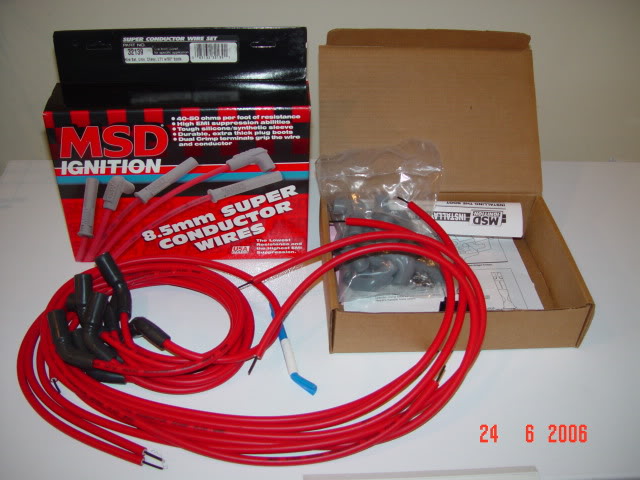

Those are MSD wires. MSD 32139

thanks, i looked them up. do they really have 90 degree distributor boots? if so, why?

They are not really 90 deg. At least the ones I bought. Probably 135. Take a look at the picture. The distributor boots poit upward at about 45 deg.
They fit great when doing OVC wires but it does not really matter.
