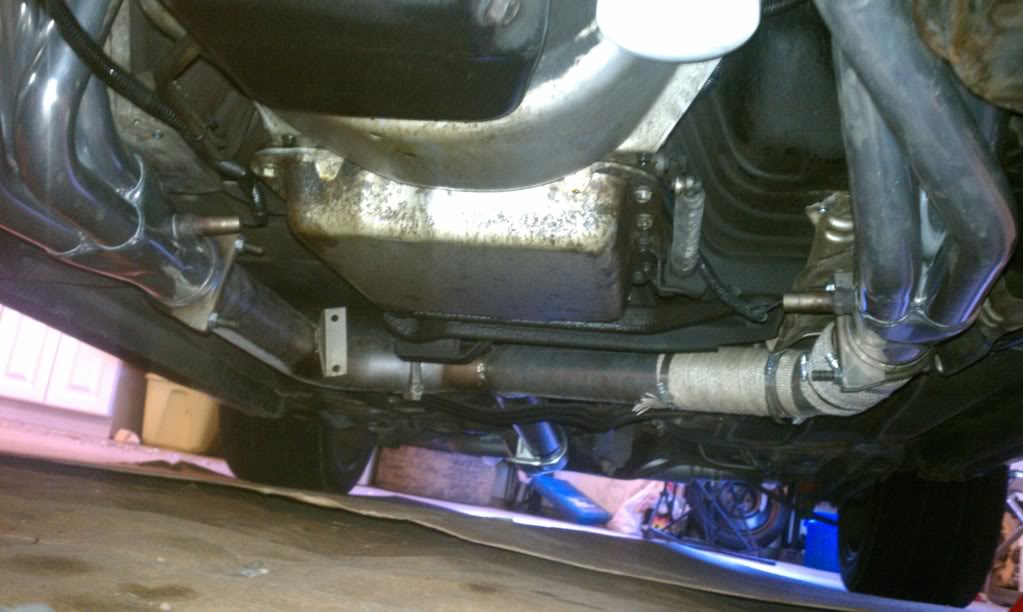

my pasecetters... the only way i can describe it is that when i get on it, it feels as if i just hit a racoon and his face slammed the floorboard right under the pedals.
this is what im working with. i still havent found it...
