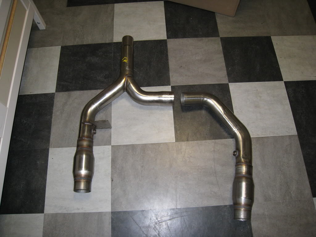

How did you attach the round opening of the catalytic converter to the oval opening of the left portion of the y-pipe?

I don't know if this will answer your question, but I'm pretty sure the cats are welded into the y-pipe by Kooks and would'nt require that you attach them to anything. I can't say definitively because my y-pipe is their offroad version, but my y came in two pieces and joined together well beyond where the cats appear to be placed in that pic.
Kooks welds the cats to the y-pipe. The front end of the cat slips over the header collector and is clamped on with the stepped clamps that Kooks supplied.
