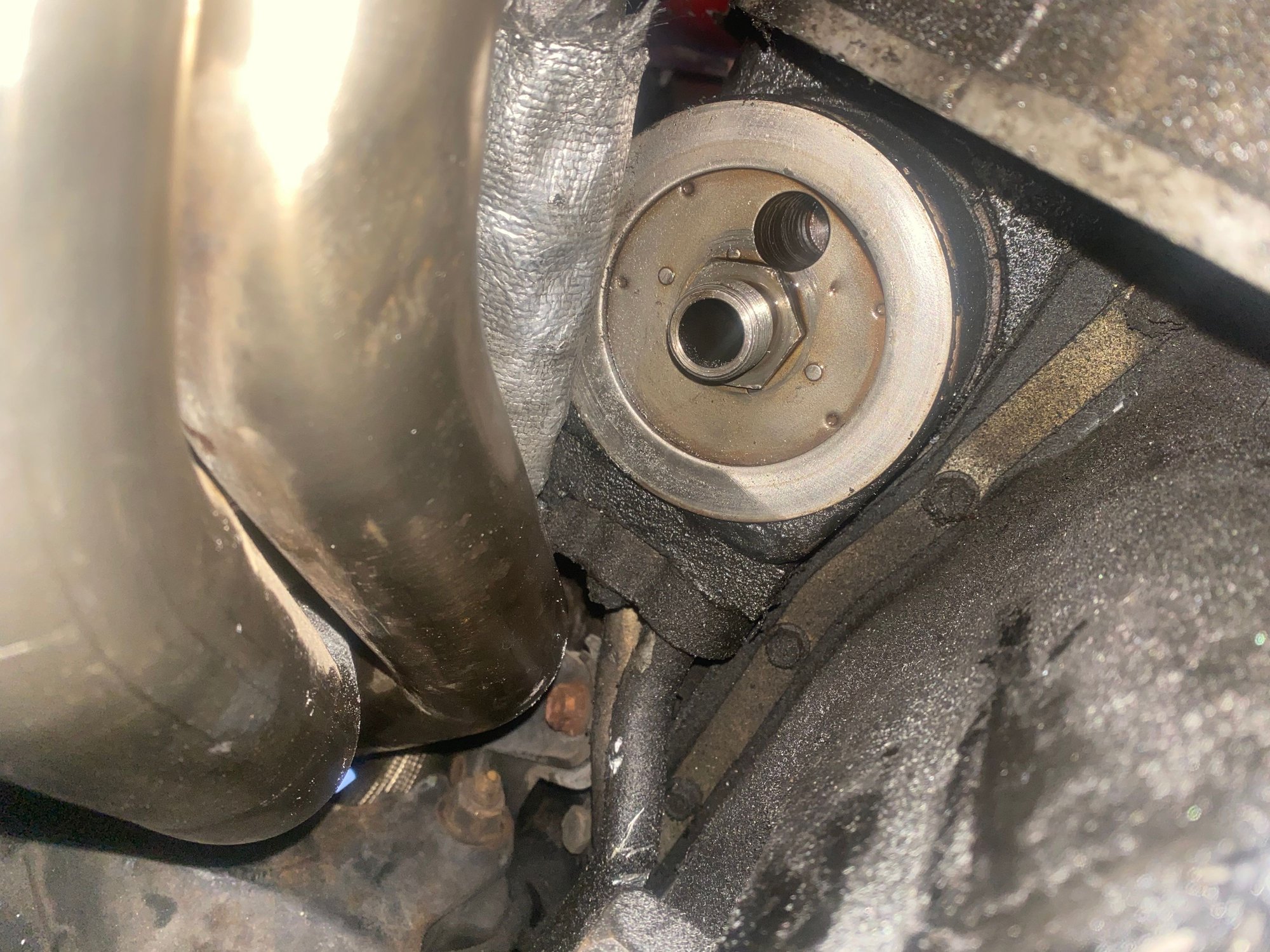

I know this is an old thread, I just installed looks lt headers on my 94 camaro and can’t get an oil filter on. How’d you go about doing so?

Looks like you still have the oil cooler installed:
https://cimg1.ibsrv.net/gimg/www.cam...e774c43ea0.jpg
Might need to be deleted. I don’t think they were still installing the oil cooler in the authors M6 car in 1996.
Just a guess.

Yeah, you need to remove that part of the oil cooler assembly and you’ll be able to fit a shorty filter like an AC Delco PF454. There are other brands with short filters that will work as well.
