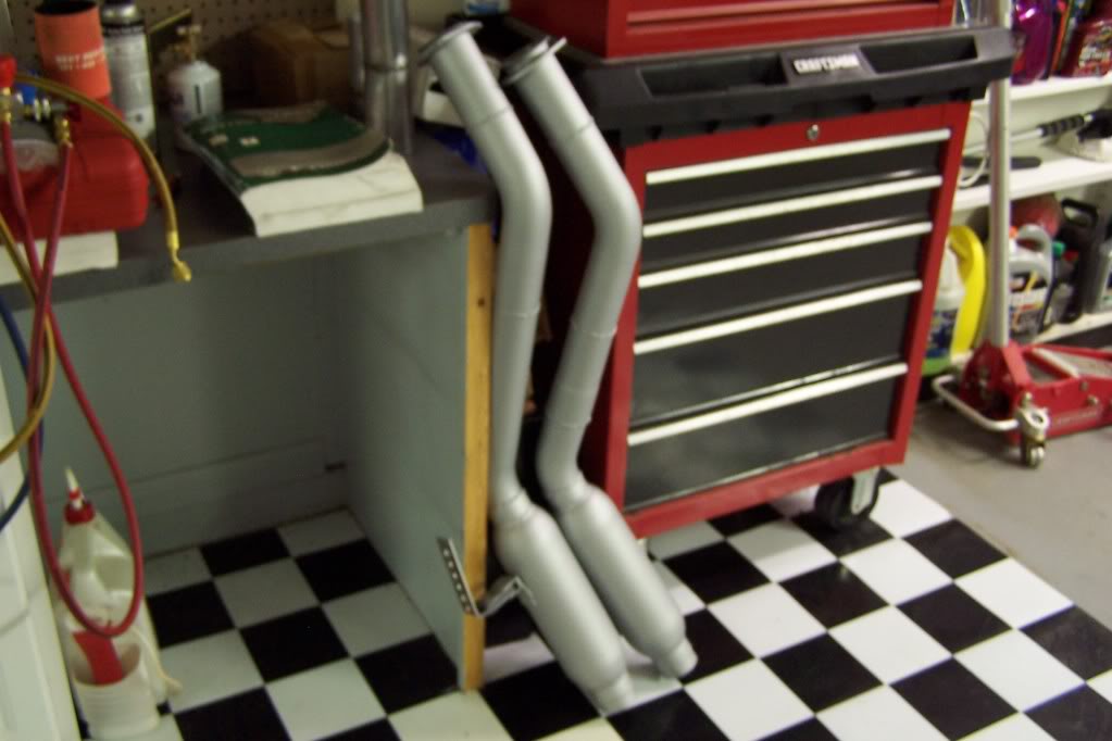

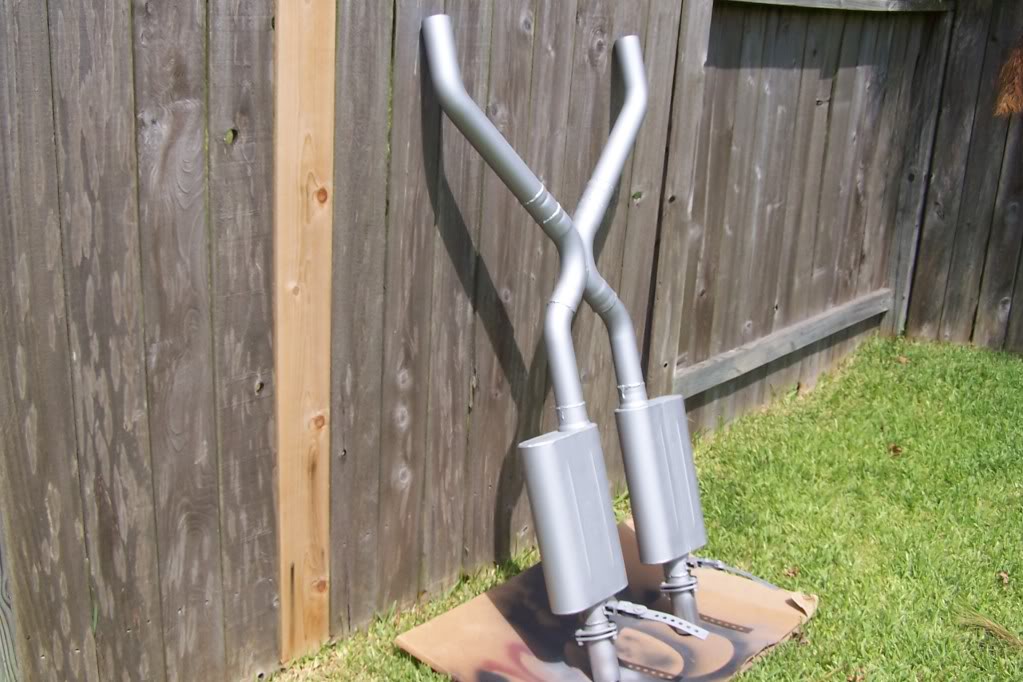

I actually finished the true dual setup last year but havn't posted the finished part of it. Anyway, here are some pics of the 2.5 inch Summit X-pipe with Edelbrock mufflers all welded up and painted. Also, I used another X-pipe and fabed up some tailpipes with Summit glasspacks. Under axle. The tailpipes connect with a 3 bolt flange. I repainted my stock tips and used a U bolt clamp them on.

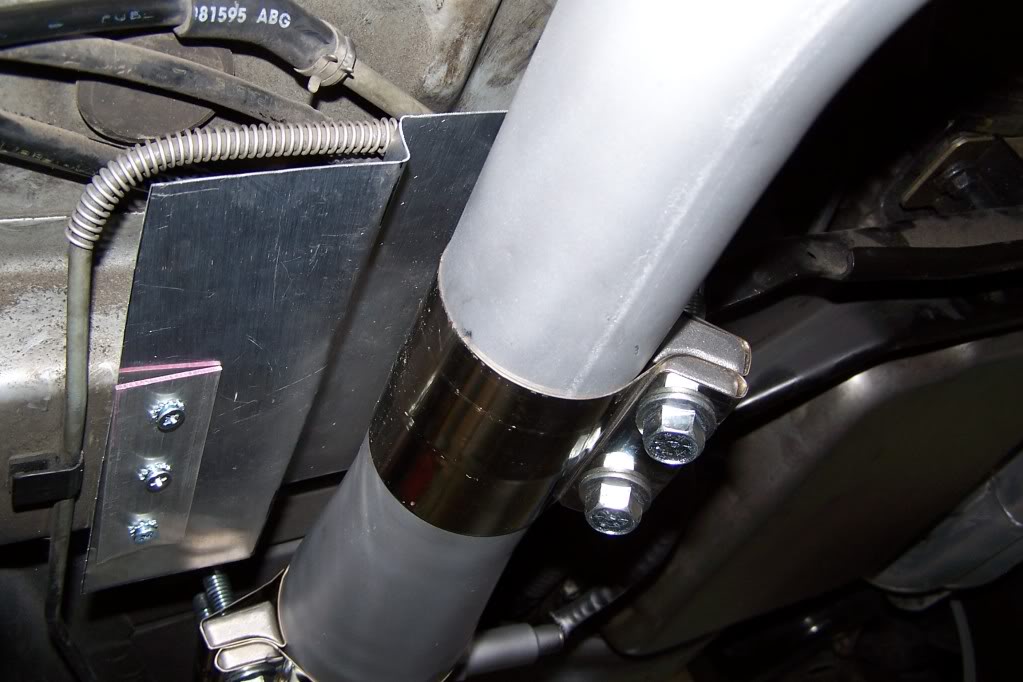

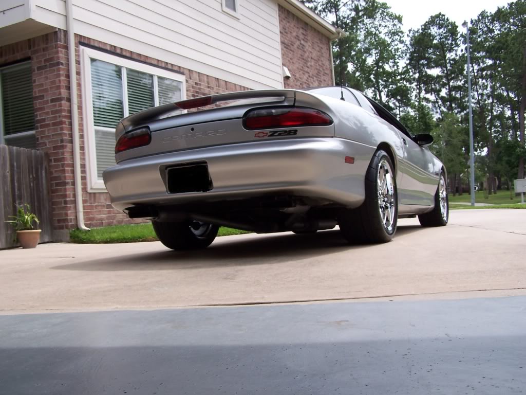

Here it is on the car.

It is actually pretty quiet with the tailpipes on. But when I take off the tailpipes it gets loud. Best of both worlds I guess. Here is the first thread I made about this when it was all clamped together.

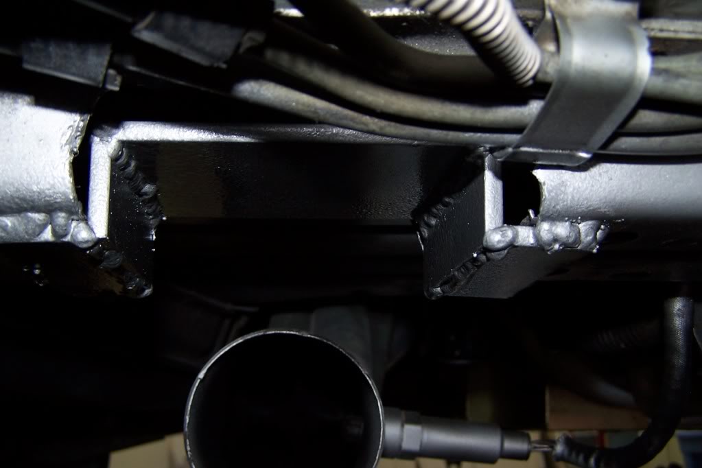

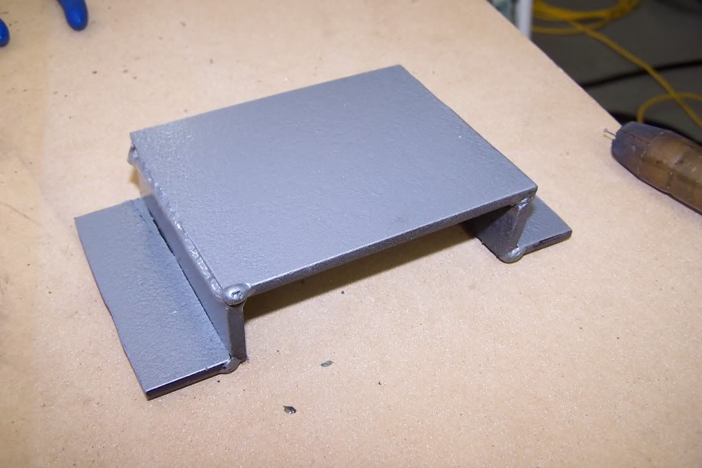

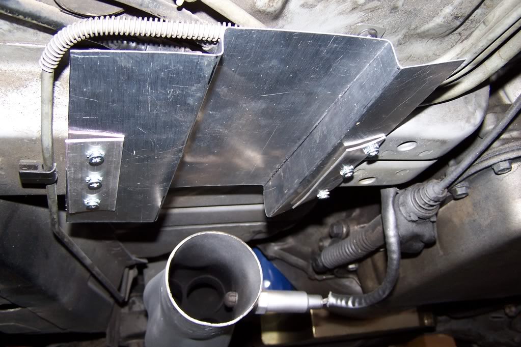

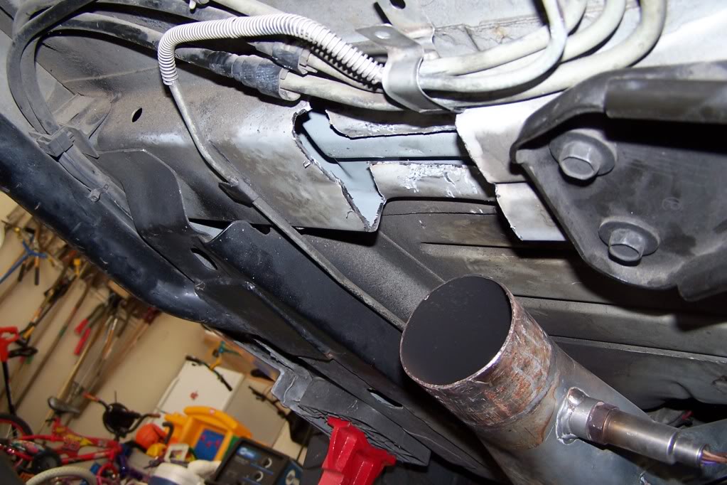

I also channeled the unibody where the Pacesetter longtube was hitting the driverside. I welded a "mini subframe connector" and welded it in place of the channel and put a heat sheild also. Here is some pics of that. It made it easy to to bolt on the new X-pipe.
