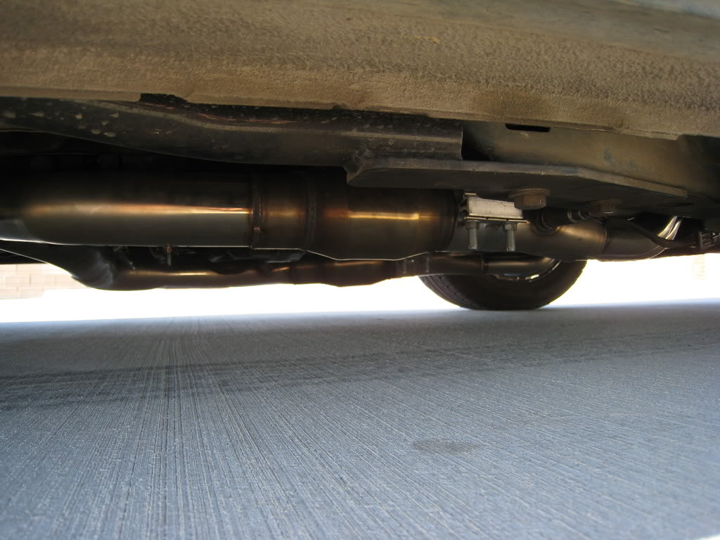

im just seeing if anyone is running lt's with cats??if so how is the ground clearance???and could u post pix??been looking into getting some lt's but want to still pass emissions! thanks for the help guys

May want to look into high flow cats (the round ones), as they won't chew up much clearance.

I run Kooks and their catted y (no idea what brand cats). Good clearance, the driver side scrapes on big speed bumps sometimes, and I passed CA smog, even with a cam (barely).

I once but the spun cats on my LPP ORY. Looked exactly like what is shown above. Ground clearance on the right side was huge but the left side went down to about 3.5". I can now install the spun cats on my TD's and the ground clearance will be much greater that what I had with the 3" ORY.

I put the MagnaFlow cats onto my y-pipe and my car is also lowered about 1.25" and the ground clearance isn't all that bad. I will drag on some speed bumps but thats about it. I will say that I think my cats did almost nothing to help my emissions so if you really want that, go with another brand.

I run high flow cats behind my Hooker longtubes. The flanges of the long tube are actually the lowest point on my car not the cats. The flanges will sometimes hit speed bumps if i have a loaded car or a heavy passenger. My car is at its stock ride height.
I ran them to clean up some of the exhaust smell and quiet down the car some.
