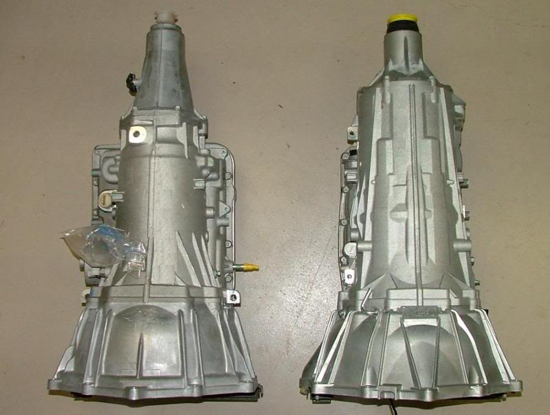

Looking at the tail shaft I'm guessing you would have to "massage" the tunnel a bit.
4586
