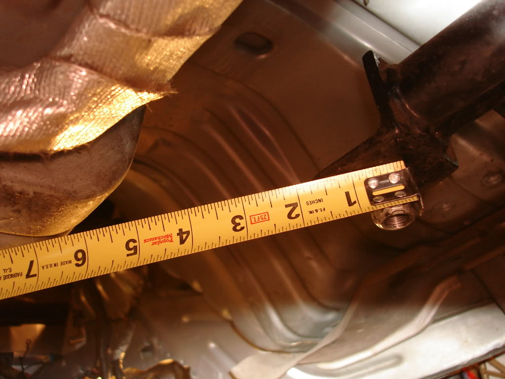

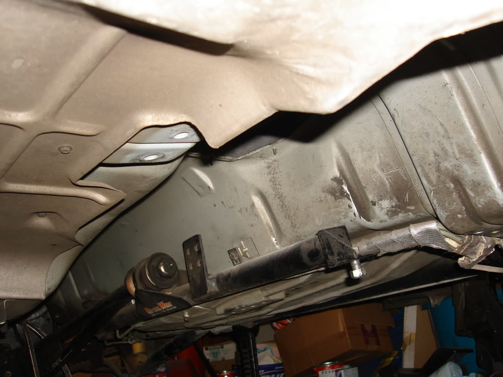

Okay just took some pics:
This is what the torque arm should look like when its correctly bolted to the rear driver's side back seat.
This is how far the bolt should be in relation to the groove on the mounting plate for the trans brace.

-B

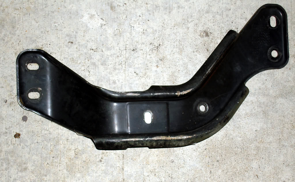

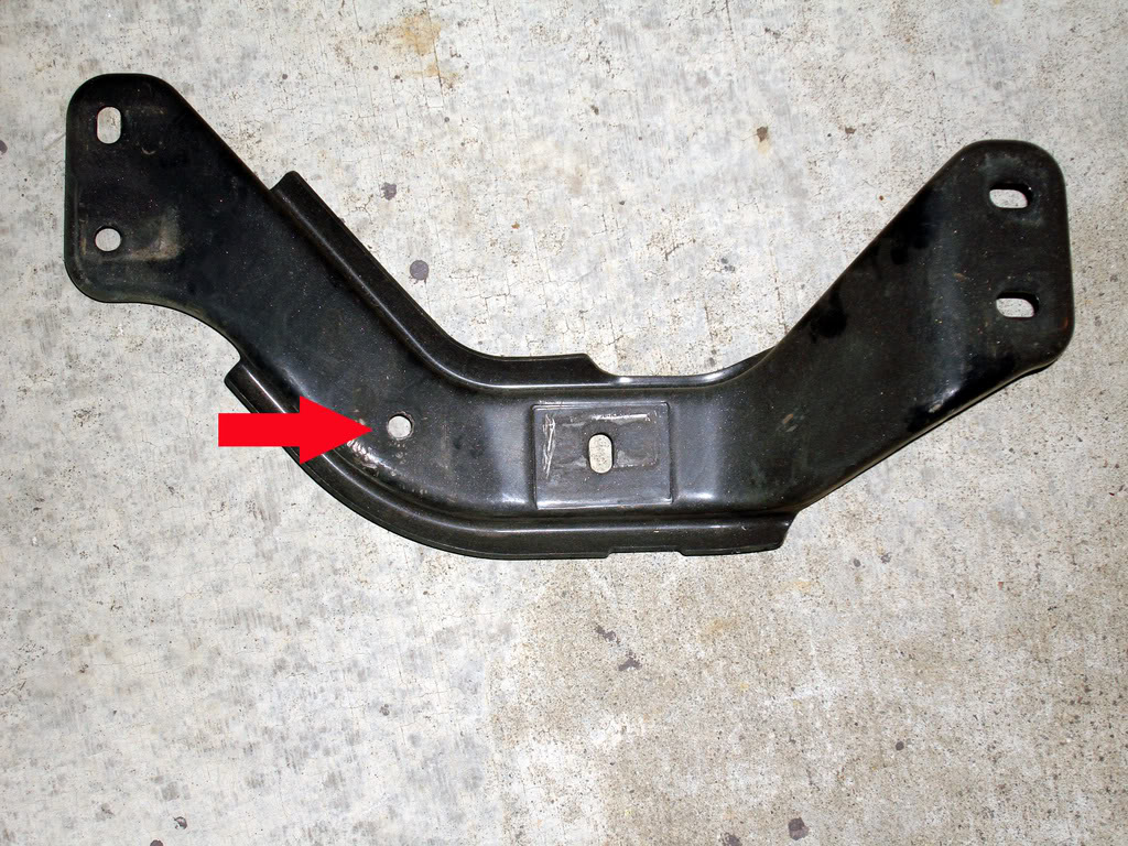

The red arrow points to the area that you should be drilling for the torque arm. This brace is for a M6 1993-2002 F-body as viewed from the top down in the installed position.

The brace flipped over.
