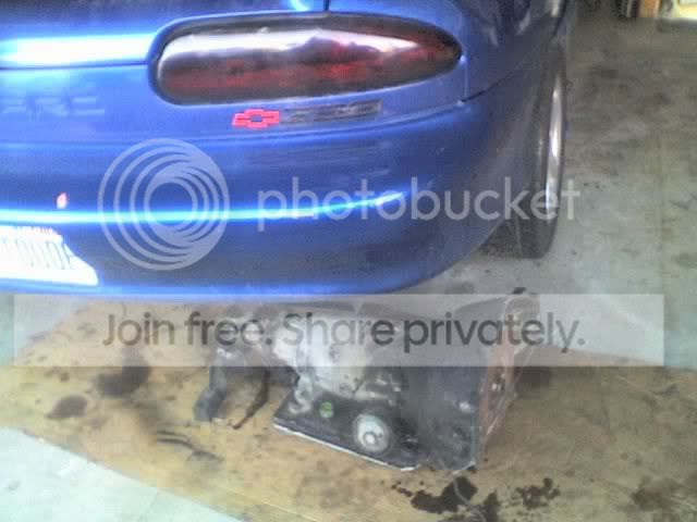

My Trans went out on the 95Z *4L60E* and its being quite the beast to pull. I've pulled transmissions before, but this sucks.
Anyone happen to know what bolt size? Metric/standard? And How many? 6? I can't see schitt up there between my exhaust, wires,dipstick tube, ect being in the way
edit: yep, 6 bolts. Finally found a decent pic

Nice, thanks for all the help Yeah, 9/16ths fits, but 14mm seems to fit better. Taking the TC bolts off was a breeze, I was dreading needing to turn the engine with a flywheel turner or something... but I could just grab the Flywheel and spin it by hand while down there. Real simple. I have it hanging down with a jack stand under the end of it thats holding it like 1/2 inch or so above where it wants to hang fully down. So its supported but down there. I got the Bottom drivers bolt out so far, gonna attack the rest tomorrow. I'm hoping to do aftermarket trans cooler when I go back in, is there much advantage over the stock one? My truck has a cooler mounted in front of radiator and I really like it.

Mission Accomplished! Those top bolts were a LOT easier than I thought
