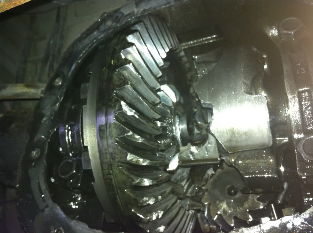

Posi unit grenaded!
took out my gears too. is this common? i thought the gears were the weak point.
