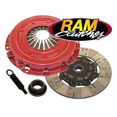

Trying to get my car back togther by monday, Had to take the tranny down three times after unsuccefully being able to get it to go completely flush w/ the bellhousing. There is always a 1/4 gap.
The thing that was wierd about my new clutch (ram powergrip) was that it has the puck type material on one side, the side which does not have the metal diamtere which comes about about 1/2 an inch. So I had to put the side w/ the pucks on the pp side (since the the metal peice which pops out would hit the pp springs)
For example look at this picture:
http://static.summitracing.com/globa...am-98730_w.jpg
See how there are pucks on that side and the metal peice in the center comes out? My clutch is the opposite where there are pucks on one side and the metal peice comes out on the other side. I belive this is accounting for that extra 1/4 inch since the splines on the tranny input shaft are running out of room to go.
Anyone ever had a clutch which had pucks which were on the pp side?
This is a picture of the exact clutch which has the inside metal thing coming out on the pp side, wouldnt this interfere w/ the pp?
the metal diameter you are refering too, is supposed to go on the pressure plate side, that metal diameter will not interfere with the pressure plate spring
if your saying the wrong friction material is on that side (as compared to your photo) contact the clutch manufacturer to verify if its correct
but right now i think you have the clutch disc on backwards

In this picture(which is newer and the pp is what I have, not like in the other one)
: The image of the clutch I have is reversed. As in the black material (non puck) is on the side which the hub extends. I am pretty s ure that the pucks are always suppose to be on the flywheel side. It seems like mine was reversed somehow. Its not possible to put the side w/ the hub out on the pressure plate side as it will interfere w/ the springs and t/o bearing. That side is suppose to go on the flywheel side where in the indent in the flywheel is made to accept it.
Anyways I got too pissed after dropping the trans twice to realign which I thought was the problem, so went out to autozone to buy their clutch, put it in. Trans went in just fine.
For some reason my powergrip which the friction surfaces were flipped somehow just wouldnt work 100%. Think its defective?
