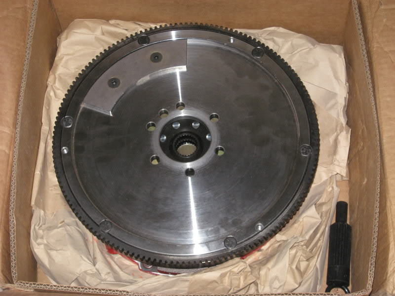

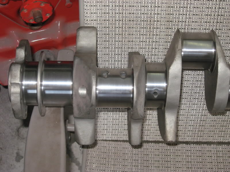

No. You need a neutral balance flywheel that bolts up to a 2-piece crank and will work with a T56. McLeod, Centerforce and Findanze all make one that will work for you. A 1-piece crank has equally spaced holes and a round tapered end. A 2-piece is more of a flange and the bolt pattern is offset. Here is a picture of my 2-piece crank and flywheel that I used to mate a BBC with a 2-piece crank to a LT1 T56. The only way you could use your LT1 flywheel would be if the crank was a 1-piece and you had it neutral balanced since your engine was internally balanced.

Compare the above picture of the end of the crank (on the left) to that of a LT1 crank. I don't have a picture readily available to post, but you should see the difference.
