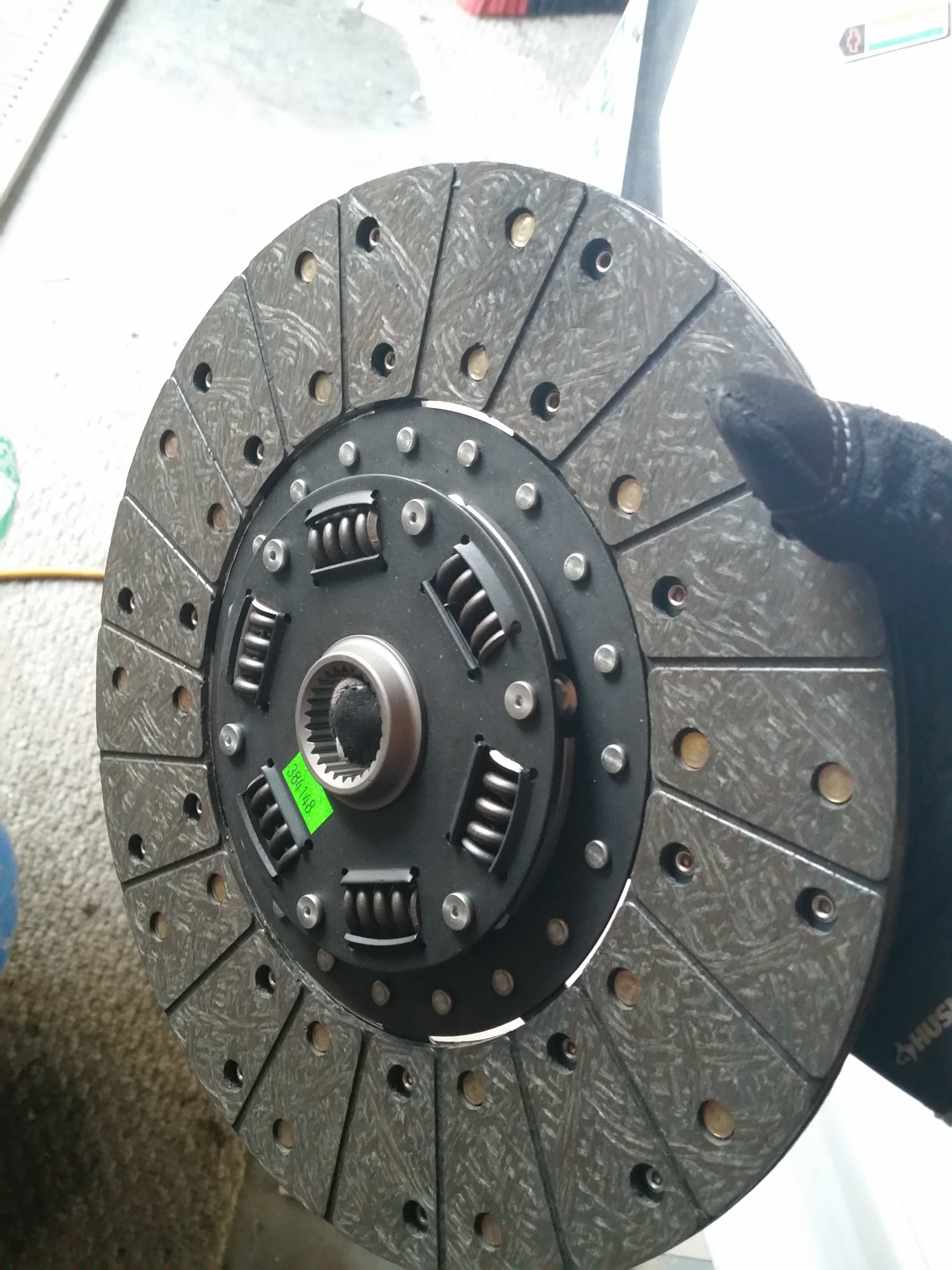

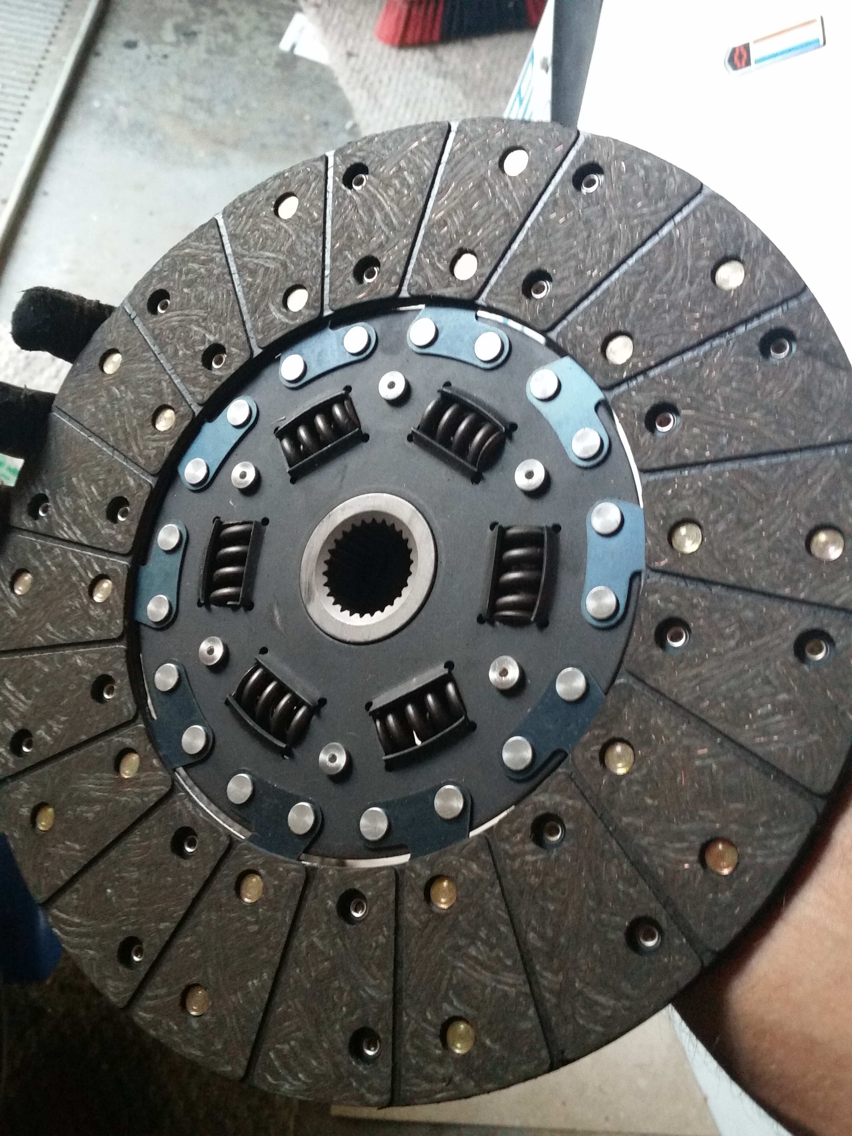

Ok another question. Should be smooth sailing after this. Exedy did not labe "fly wheel side" any where. So does anybody know the flywheel side? Seems like opposite side of the springs.

I might have figured this one out but comments are still appreciated. When i put the disk flat on the fly wheel it turns with out the springs hitting the fly wheel bolts. When flip it and put the disk on clutch cover the springs hit the clutch cover prongs.

the side with the green tape on it goes against FW
TQ PP bolts to 22 ft lbs, no more.
FW bolts TQ to 76 ft lbs

Thanks Chimera96 for both answers, much appreciated.
