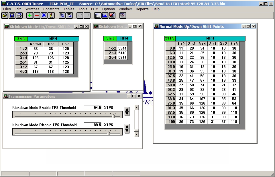

Here are the stock shift settings, to let you know when the PCM shifts and then compare to when you feel the tranny shift. If they don't compare then, you are not stock tuned or the tranny is not acting correctly. They are from a '95 3.23 tune but s/b the are same for a '94.
The right side 'Normal Mode Table ' is for normal driving (non-WOT) it shows when the PCM commands the upshifts and downshifts based on speed and throttle position during street driving
The other tables are for WOT or PE and are called Kickdown mode, the bottom left tells the PCM when to activate the PE or Kickdown shift tables that are above it. As you can see stock setting enter Kickdown at 94.5% TPS exits at 89.5 %
You have to satisfy 'BOTH' of the top tables to shift, it's an 'AND' condition. EG: to shift into 1st>2nd in Kickdown mode you have exceed 36 MPH and 5344 RPM, 2nd>3rd 73 and 5440.
