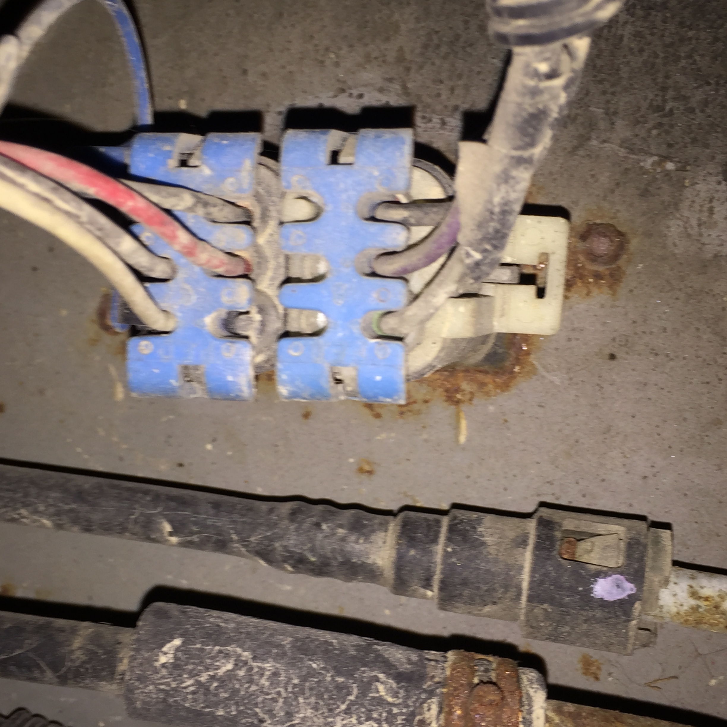

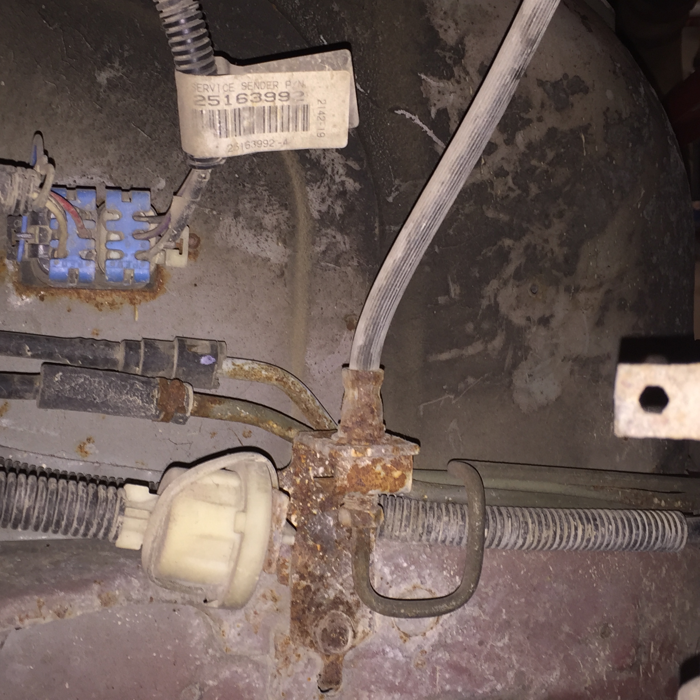

Old Jun 15, 2017 | 03:21 PM
Greg88's Avatar
Joined: Mar 2007
Posts: 365
Re: 12 bolt - 4 Channel into a 3 Channel Car
This is my harness, looks like it has TCS but I could only see one brake line coming from the front. The brake line does not look factory though.
Attached Thumbnails 12 bolt - 4 Channel into a 3 Channel Car-img_5769.jpg   12 bolt - 4 Channel into a 3 Channel Car-img_5770.jpg
