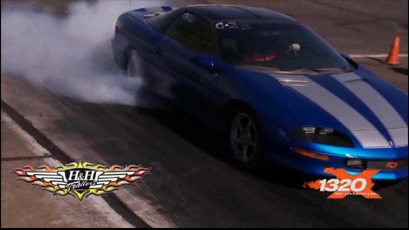

i know that it shouldn't overpower the tire, but this screen shot from the video was running 17lbs with the track nicely preped for a TV event, i'm doing a nice smokey burnout and still ended up spinning off the line giving me a 1.88 60', the next pass i brought it all the way up to 24lbs and got a 1.89 60', then i tried 15lbs and 1.90 60', i tried going as low as 11lbs on another day and had about the same results
you think its just not transfering the weight corrrectly, i know it feels like it pushes the rear to the right off the line
Yes, I think this is correct. Remove front swaybar, used adjustable fronts, and adjustable torque arm.
I don't know about the 16" dr's, but my 315/17 dr's were useless, with stock power level, until I got a suspension on the car.
