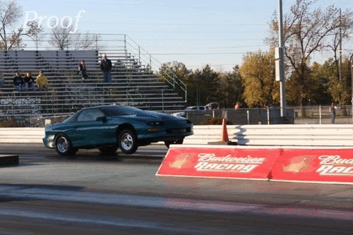

I would use a 4 jet spread with the nitrous jet being the bigger one. Setting the flowing fuel pressure at 5.5 to start but if your reading the plugs you will have to drop the fuel pressure a little more. I would also pull more timing here is a vid with a .075 nitrous jet and only a total timing of 20*
http://www.youtube.com/watch?v=87beVxhczc8
There is more power in that jet I just start safe on timing read the plugs and add timing tell the mph stops going up. The next pass was over a tenth faster with a 1.5* more timing.
