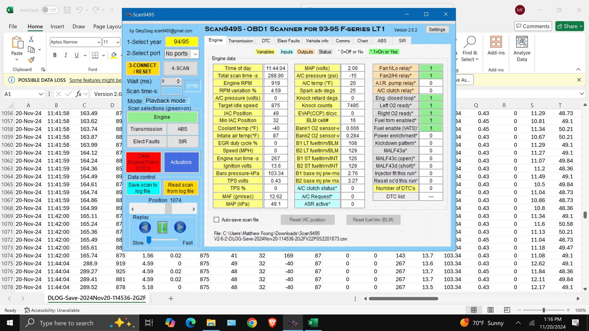

Newbie to LT1 and trying to diagnose a cutout/bucking problem with my Triumph TR7 that the late PO did not finish. From the screenshot you can see the excel file where the changes occur #1074 to #1075. There is a big time jump, Coolant temp goes from 169 to -40, Fan1 Relay and Fan2 Relay both turns on(They don't exist on the car, a manual fan switch is in place).
My BIN file opened with Tunerpro showed standard Fan Enable Coolant Temp of Fan1 Lo 107.8 and Fan2 Lo 113.
What is happening? Is my coolant temp sensor defective or the non existing Fans turning on cause the -40?

Just a guess - possibly the PCM stopped reporting on the data wire for 2 minutes, or your computer stopped recording. Never saw this happen in the 100s of data logs I've reviewed. Did you try and run another log after this one? Is the PCM still functioning normally?

The lapse between 1074 and 1075 was ~124 seconds. Where did that data go?
Check temp sensor and 12 volt supply:
http://shbox.com/1/4th_gen_tech2.html#ect

DTC 77 tells the PCM the relays aren’t there. The 0/1 indication of the fan relays may just be the PCM tripping the internal switches to activate those relays in programmed logic response to DTC 15.
I added the coolant temp test procedure in previous post.

The fan and coolant temp sensor circuits do not overlap. The fans are operated through PCM connector “A”.
http://shbox.com/1/1995_pcm6.jpg
The coolant temp sensor feeds through connectors “B” and “C”.
4th Gen LT1 F-body Tech Articles
You've got some issues with the Bank 1 O2 sensor. After 1075 the PCM entered closed loop. It normally can’t enter closed loop until a timer (206 seconds from start) times out. That occurred during the missing data. When the PCM goes into closed loop, the O2 sensors should start to toggle back and forth between lean (~0.1xx volts) and rich (~0.9XX volts) Your Bank 1 sensor seems stuck at ~0.6xx-0.7xx volts. The PCM tries to correct the (apparent) rich condition by lowering the Bank 1 long term fuel trim (LTFT). Your LTFT drops to the minimum value (108) pulling out 15% of the normal fuel, then starts dropping the short term fuel trim (STFT) to pull out even more fuel. Yours drops way down. Bank 1 was probably running way too lean after 1075.
Test the temp sensor and reference voltage before starting to replace parts.

Thank you for looking at the log and explaining them. For a newbie that is like getting an advanced bonus. Yes, I noticed when I first started up the car, the right O2 was ready very quickly while the left O2 was not. I was planning on getting the O2 sensors replaced anyway because the O2 sensor wires were touching and sort of wrapping around the shorty exhaust headers. I moved all the wires away but who knows how long they have been touching.

I tested the temp sensor, and the ohm reading was way off with an ambient temp of 71. I replaced it with Autozone SU109, and there is no more funny business going from 169 to -40. The O2 sensors will be replaced tomorrow, and hopefully, there will be a nice test drive.
Since I have your attention, I have been meaning to ask about something I have observed since I took ownership two months ago. When the car is idling, every once in a while, the idling will change like a burp for a split second and then back to normal. On Scan94/95, you can see the Fuel, O2, and Closed Loop values go blank and then come back. Is this normal?
