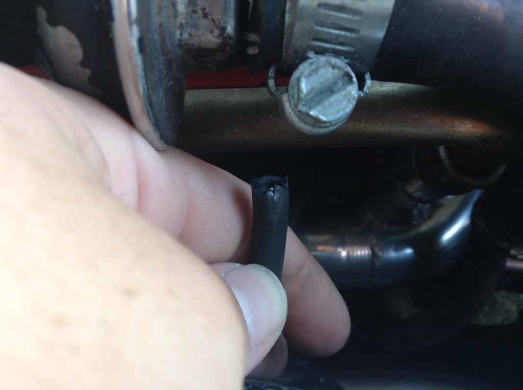

Ok so I checked the spark plug wires today and found out one of if not THE problem(s) with my misfire.
My wire on the right side Of my motor fell off into my hand when I tried to removed the boot from the plug.
I added a picture showing where the wire was dry rotted and arching to the headers. You can see where the heat was radiating through the wire. Its charred from the inside out.

So I replaced the spark plug wires and they all had numerous dry rotted spots. They also had chunks taken out in various places throughout the wire (like mice had been chewing on them or something).
Anyways I started the car up and it runs like a champ now. I finally have the feeling I remember with the old motor but its a lot faster
Glad to finally have a working car again. Thanks to everyone who helped out over the numerous threads.
