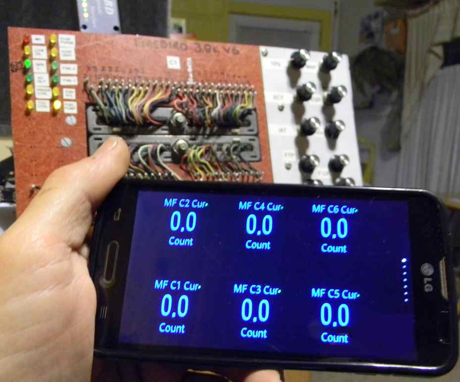

Here's a photo showing a sample screen with misfire counts for all cylinders of a V6.

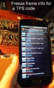

The Torque app can also display freeze frame info for the DTC's.
