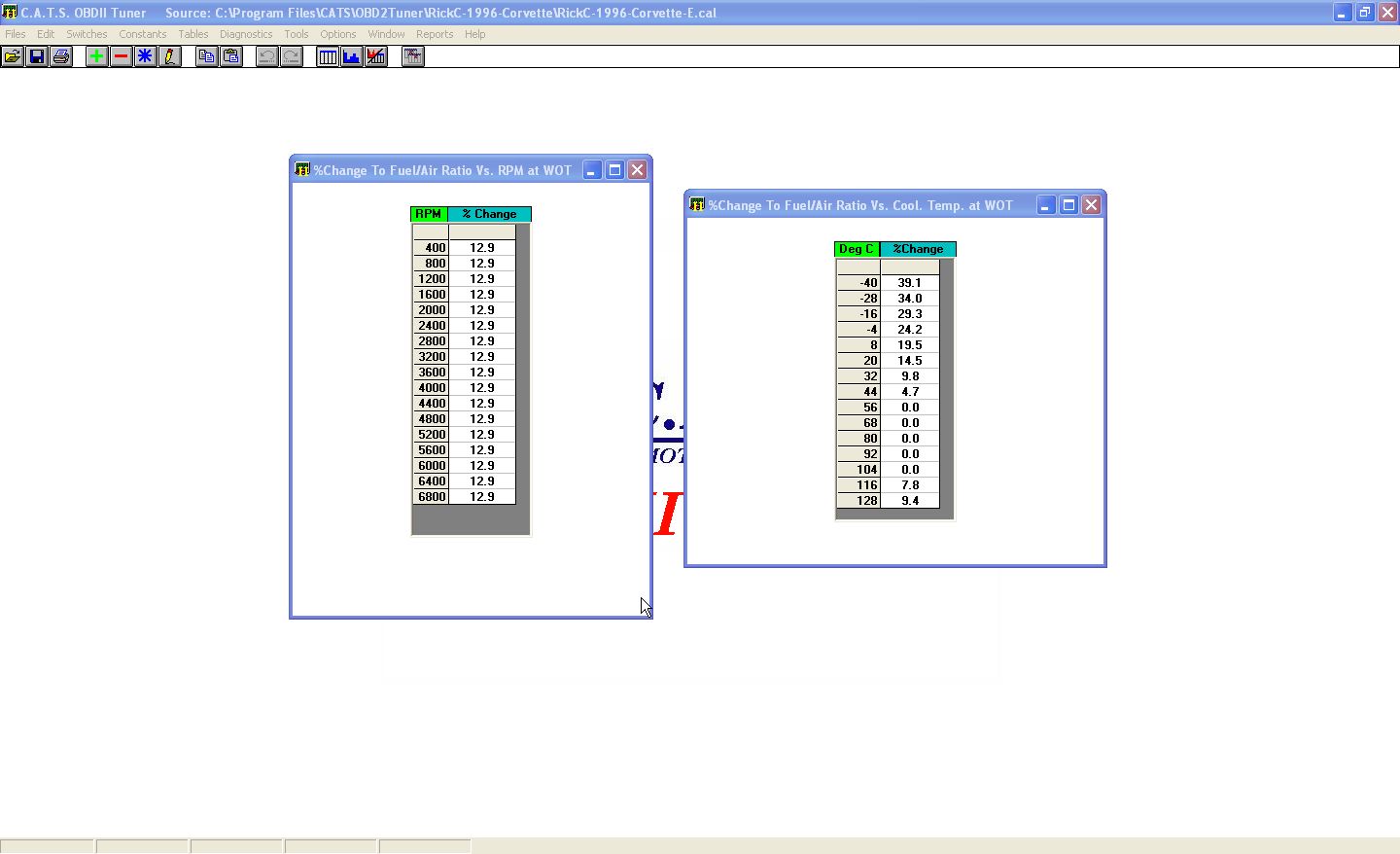

i us % Change To Fuel/Air Ratio Vs. Coolant Temperature
But I read this topic Do you think this method is correct
This is how I set up the PE tables to command a 13.0 AFR at operating temps on the LT1/LT4 cars. Then scale the Maf so the actual AFR matches.
Also enter 14.7 in all cells above 68*C in the open loop AFR vs coolant temp vs map table.
Russ Kemp
(% Change To Fuel/Air Ratio Vs. RPM)

Re: how to tune lt1
little confused here...the screen shot header pic says 1996 corvette. The file your uploaded is a 95 camaro. Also the fuel tables in the uploaded file is not the same as the screen shot. On the file..I see 12.5 commanded at wot at 4k rpms,and 13.2 at 5200.
dont be confused my car is a camaro bot Copy the words of (ress kemp)
To see if I can do like him .
you see my file ?
What can I do to lean the fuel
