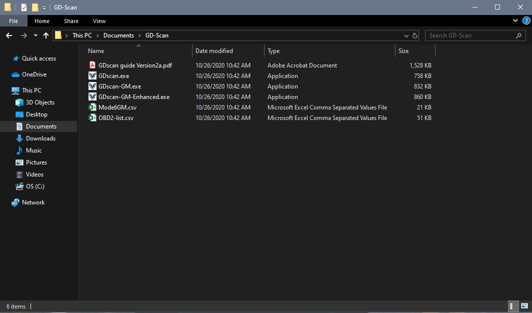

1) Make sure you have extracted the files from the zip file
2) Check that the following files are in the same folder as the gdscan-gm-enhanced.exe file: mode6gm.csv and obd2-list.csv

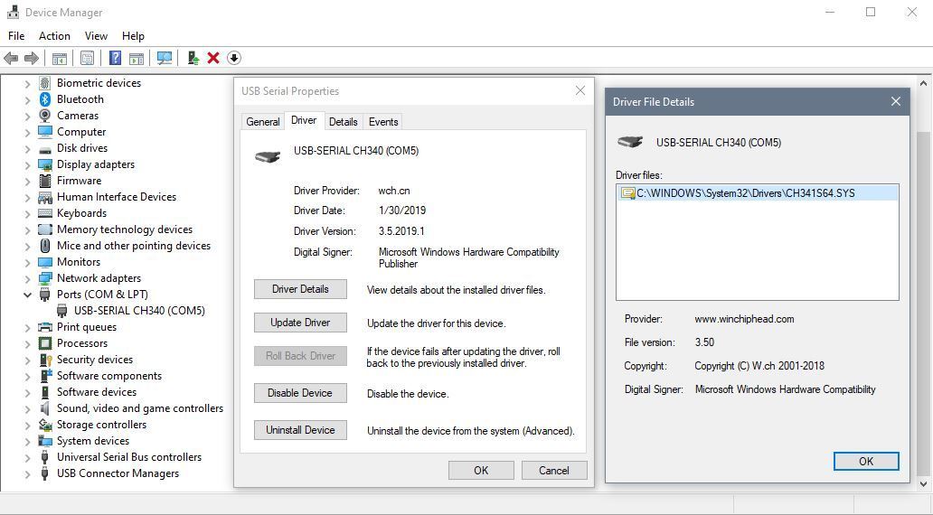

I've made sure to download the drivers that the adapter says to, although I'm pretty sure Windows did automatically anyway. It is showing up under COM Ports so I believe it's working.
I also have all the files that came in the zip file, and they are extracted to a regular folder.

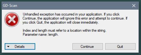

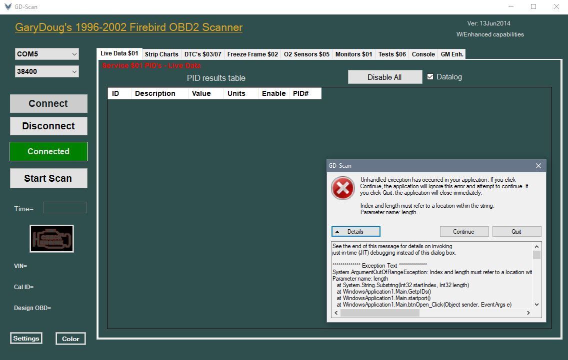

One interesting thing that I noticed is that the error only appears when I run the GDscan-GM-Enhanced version of the program. The GDscan and GDscan-GM versions do not show the error, however they just freeze up and stop responding, and I have to end them through task manager.
Sorry Gary, just refreshed the page and saw the questions you added:
When I get the error message, nothing shows up on the PID list. it just looks like this:
If I click continue, the dialogue box goes away but nothing shows up in the program.

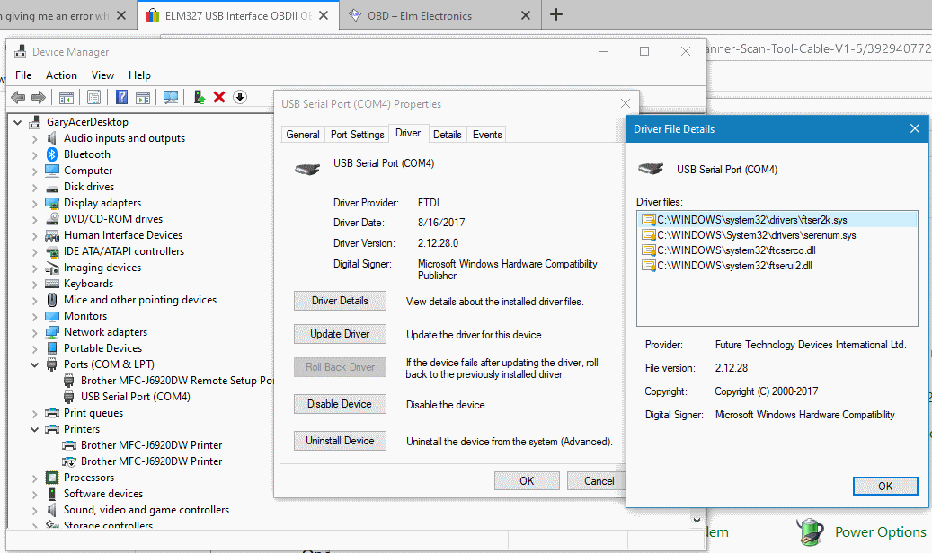

Re: GD Scan giving me an error when I try to connect
Wrong drivers; they should be from FTDI
Safest version is the one shown in this image

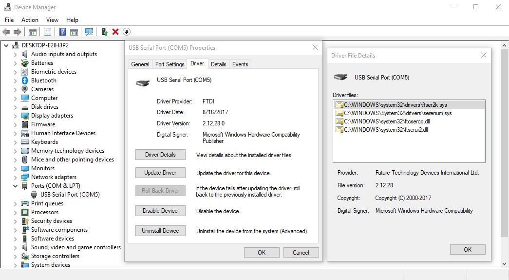

Ok so I was able to get that driver installed for the device now! Windows was automatically downloading the other one too fast but by disconnecting from the internet I was able to manually select the FTDI one. Now when I click connect I get this error:

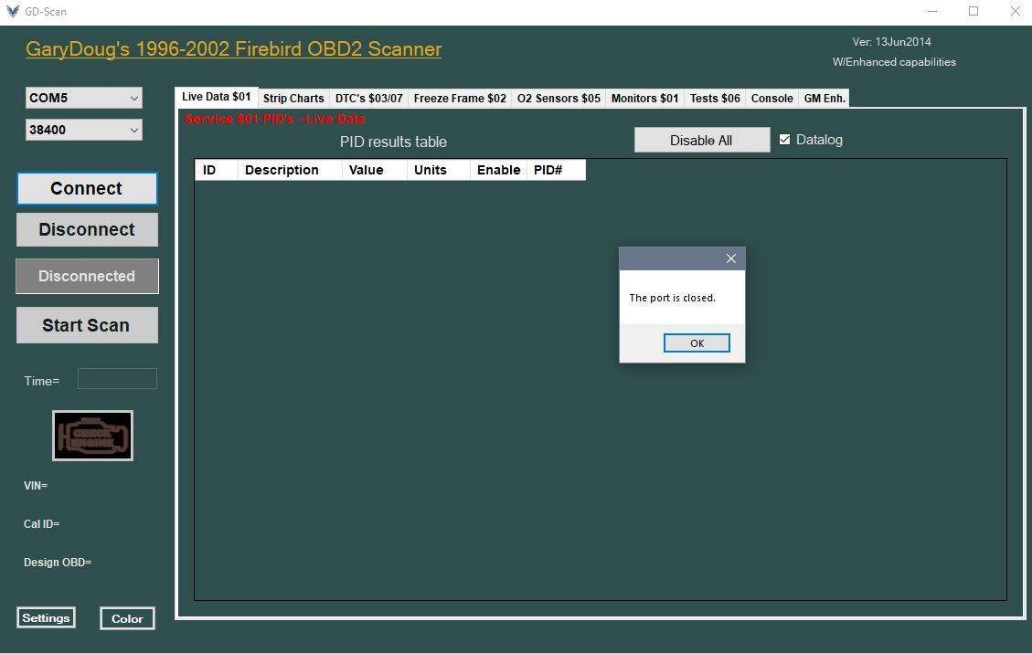

And when I click OK I get:

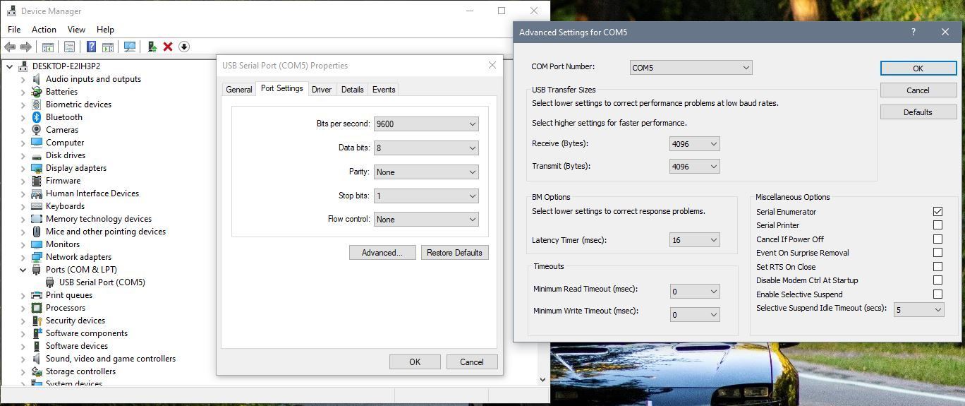

I know COM5 is the right port because it is the only one that shows up on the dropdown. Also, it shows the USB Serial Port is COM5 in Device Manager. Here is a screenshot of the port settings. I don't know enough about these to know if I should be changing anything. Thanks again!

Try rebooting the pc. Also, the port settings in your attachments are not really important because the program resets those values when it starts. More important info are the driver file names on the Driver tab.

Rebooted the PC and I'm still getting the same thing. Here's the details of the driver now. As far as I can tell they're the same as yours.
