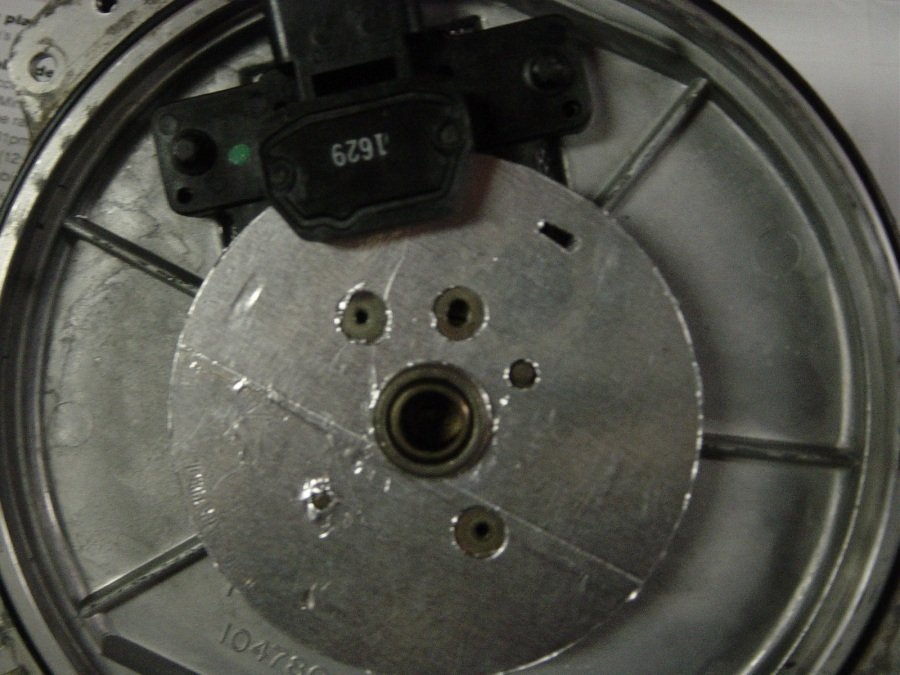

initial test. good.
Be honest. Let me know if you think my mod (shown below) will work.
By the way, this is for the purpose of being able to run in sequential mode for use of 160lb/hr injectors on an F2 blower LT1-383, (to be able to idle).
I used aluminum tape (both sides) of GM optispark optical disk. I covered all the slots accept the existing slot that I found to be 35 to 45 cam degrees BTDC #1 piston (which would be 70 to 90 crank deg BTDC.)
Tested with a Digital volt meter on an engine stand motor and I got a pulse when #1 piston was around 80 deg BTDC on the crank. (just by eyeball). So on an engine stand it worked.
Seems like it should work and provide a pulse to the XFI discrete cam position input when #1 piston is at around 80deg BTDC so that sequential mode can be used. There are a bunch of wiring pin changes to do on the XFI opti harness and "hall effect connector" for this to work. The XFI tech told me what and where. (I don't have the harness...it's in Sweden and I'm trying to help the guy there with this set up). Basically you move the crank position sensor now from the opti to the crank trigger wheel on the crank and you provide the cam position via the 1x optical disc pulser in the opti--(that I just made). Move the GM opti harness pin A low res. pulse to pin C because pin C in the XFI harness is the discrete cam position sensor input. Also provide 12v to GM opti harness pin C (somehow) and also GM opti harness pin D needs ground (I think pin D needs to go to the XFI distributor ground pin input but not certain). He said loop pin A and B together and loop D and F together (whatever that means) on the hall effect connector harness. If I had that harness here I'd be able to visualize this and give clear instructions...sorry.

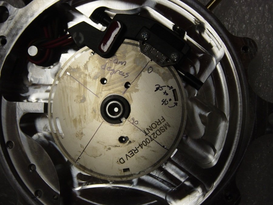

Photo of my protractor marked MSD opti disk,
http://www.ellweinengines.com/optisp...kmodified2.jpg
Leading edge of that slot is at 45 deg BTDC and trailing edge is at 35 deg
Photo of my modified GM opti disk,
http://www.ellweinengines.com/optisp...skmodified.jpg
All assembled and on a motor on a stand it seems to work. Hope it works with a running motor at high rpm and under load. The aluminum tape seems to be robust enough for now. If it melts under heat and flys apart then a fabricated/machined disc is needed.
