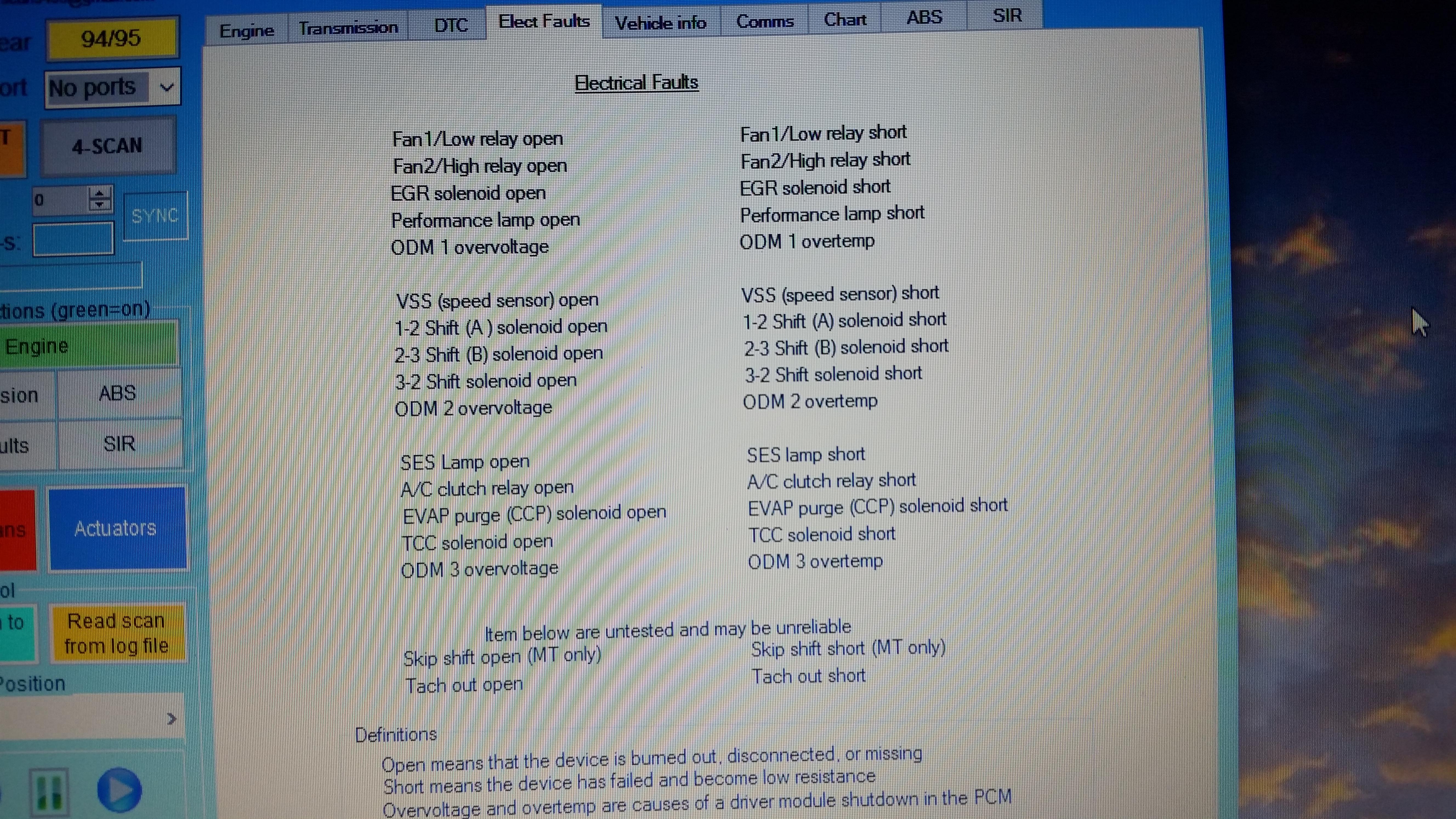

Thanks Gary for your reply, what I meant about DTC fail was scroll to the end of my attached Excel file in my opening thread and see that it say's DTC fail, your program is fine. As for the MAF, I just replaced it in March of '16 with a Standard brand unit, I don't think it would turn the fans on to run constantly, I may be wrong though. I do get a bunch of electrical faults by your program. I will attach what your program found.

The "DTC Fail" column is always in the log file. In your file it is empty of any codes.
If that screen you attached is during a scan, there are no current electrical faults, otherwise they would be highlighted in green.
