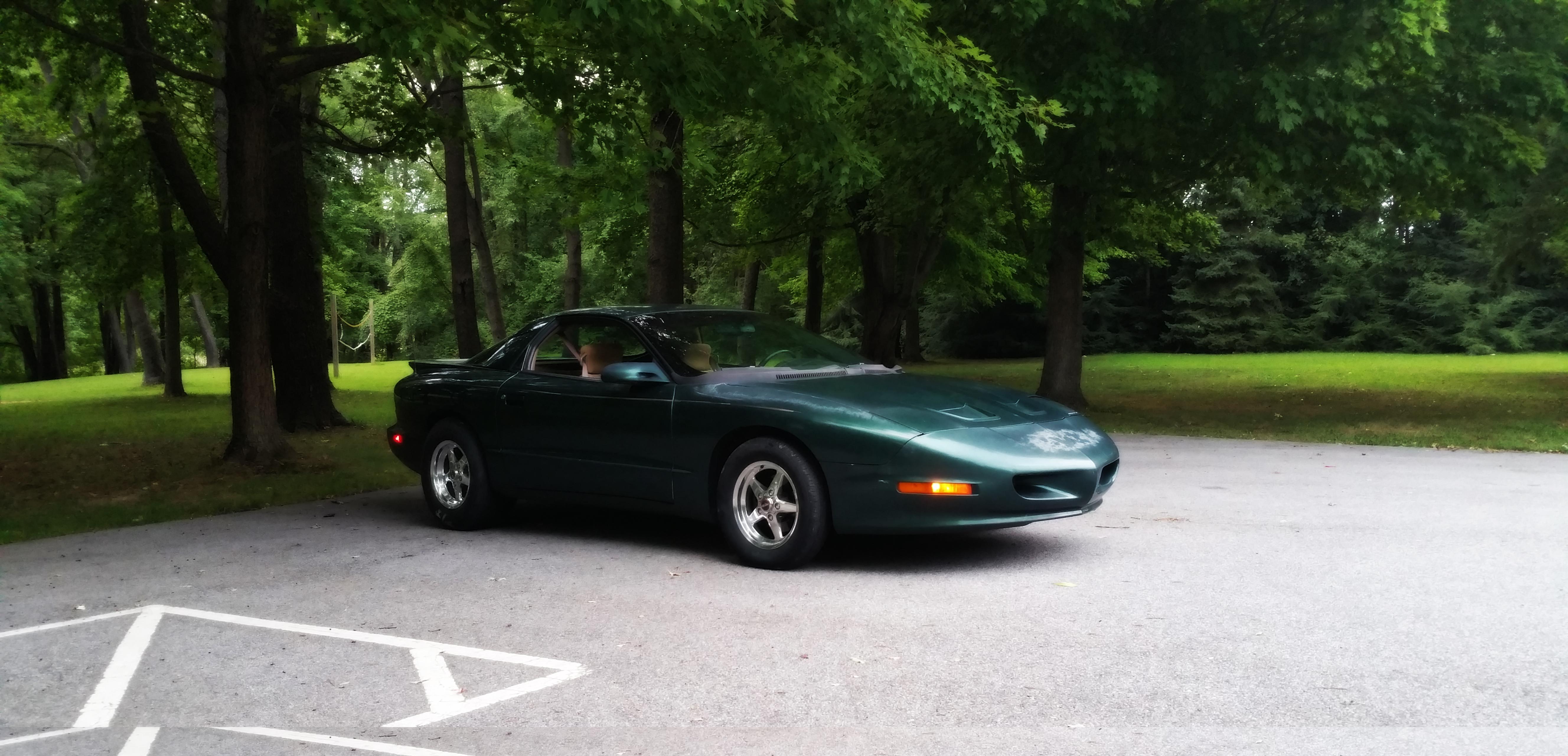

Then finished the nitrous install
Not bad for a $400 car and $500 for Engine/Trans/PCM + misc. I have about $2500 invested so far with car/engine/gaskets/converter and all the bolt ons
