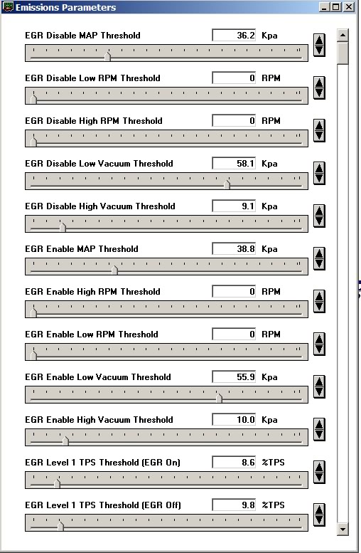

Wes, I looked at the 2 .bin files you sent and neither are stock, I don't like the EGR settings , both files are the same, but look incorrect for disabling EGR. That may be the cause of no BLM Cells 16-18. I attached the correct disable settings below. The files you sent have modified idle speed, low speed down shift, some high end timing has 5* lower advance in the HP file and + 2* higher in the stock, but only in 2-3 cells not a specific operating MAP/RPM range IAC park position changes at low temps are changed?, Throttle follower settings at higher speeds are altered, and DFCO spark retard is higher. Sort of scattered changes that don't look coordinated towards any specific direction. EG: Idle in N/P is set to 587 instead of stock 550, 37 RPM is not really noticeable and not needed for a stock setup. Your fueling (MAF) tables are OK and are stock. I would suggest loading the stock .bin I sent, adjusting the speedometer settings to fit your tires and rear gearing, when the popup to adjust all tables comes up say yes. That should adjust the shift tables for you. Crank up DataMaster and you should be in BLM Cell 16 at idle, if not let us know..
EGR Disable settings, only four (4) fields need changing to '0' all orhers are the stock settings.

Bob, I will do that. I will just take all the numbers for speed from the file I have now and transfer them to the stock file. Also my VIN number. Is there anything else I need to transfer to the stock file? Maybe sift points? I have not tried to disable the EGR. Actually I fixed it because it was throwing a code. Is there any benefit on a stock car disabling the EGR? Right now I am shooting for best MPG. There are no emissions checks where I live. When I bought my hypertech it killed my PCM the first time I used it. I sent the PCM off to hypertech and they fixed it by flashing to "stock" I am wondering it the file they flashed it with wasn't stock?

Could someone look at the text file that shows the differences and maybe give me some tips on what to change to make either one of the bins work correctly? I see no differences on the EGR settings as stated from Bob.
