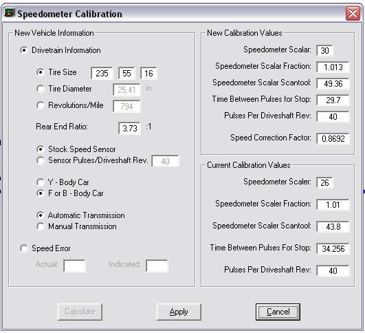

Then this pops up and you put in the info that is correct now and hit calculate and then apply.

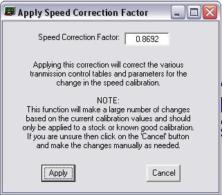

Then this will pop up right after you hit apply and you should click apply again.

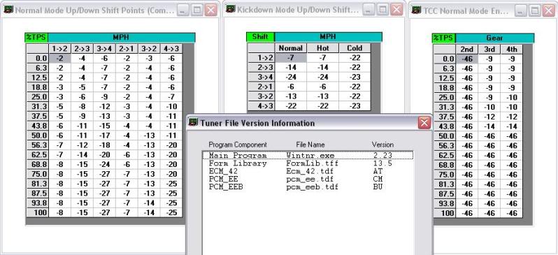

And save the new file denoting the gear change. Open it and compare it to the original file in all the tables. They are all now lower to keep the rpm the shifts occur at the same even the kickdown tables and lockup. I also put my version information on there.
