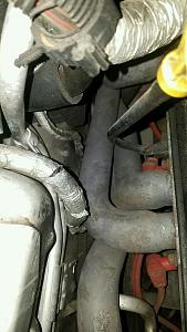

I believe he did check the fuel pressure, but I will triple check with him. Water pump was replaced during rebuild, and coolant gauge works correctly, not sure if that means its ok or still need checked. Upon further inspection in the engine compartment, looking for the passenger side O2 wires, came across two harnesses sitting on the headers. One looks to be near the back passenger side exhaust header, is a two wire that runs up near two connectors on the passenger fender, is a twisted green/orange or green/brown see pic attached, and runs into the loom going towards the fusible links by the battery junction. The other is a larger harness sitting on the middle two exhaust headers passenger side, and looks to run into a larger loom up by the pcm, that connects to the main harness that runs across the top back of the motor. I took pics but I guess phone didn't save them. This harness would be about dead center, maybe a little rear of the inside of the wheel well, running up to that back passenger corner. Any idea what these harnesses are? I moved them, reconnected the battery, and it fired right up, but still wasn't quite right. Let me know your thoughts, thanks again for the help.

There are two coolant temp sensors. The one in the driver side head if for the gauge, and doesn't affect how the engine runs. The one in the water pump feeds the PCM, this is the one you need to check. Gauge can work fine, but faulty circuit on the water pump sensor can cause the engine to run rich, if it's telling the PCM the engine is cold, when it isn't.
Here's a 1995 harness. Your 97 would have additional connectors for the EVAP vacuum switch, the two after-cat O2 sensors, and the crank position sensor. None of those should be causing your problems. A pre-cat O2 sensor shorted to ground could cause it to run rich.
1995 Z28 A4 Engine Harness
I'm not in a location right now where I can access my factory manuals and check the specific wires you mentioned.

Thanks so much for the help. The harness wedged against the header contains the ground for the pcm, a knock sensor wire, and the precat RH O2 sensor wires. At this point, after showing my mechanic the pictures, we believe this harness is arcing/shorting to ground and is the cause of the problems. My mechanic has offered to fix it, I will update on whether this was the problem or not. The help is REALLY appreciated, thanks for taking the time to read and respond!
