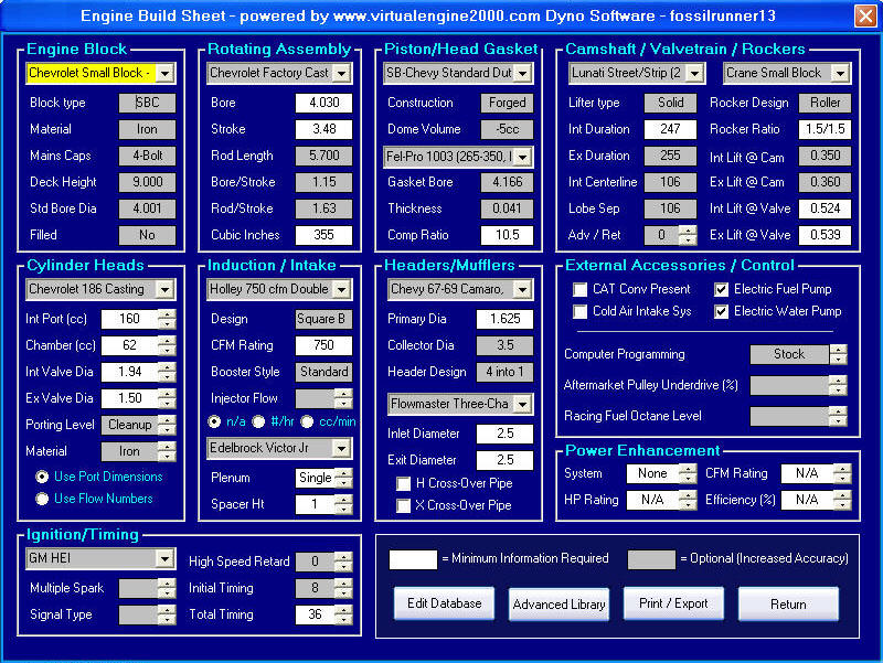

Its not a camaro but it is a chevy and you guys are all pretty smart so I figured I would ask here. just pulled the tired 305 out of the nova this past weekend and the new 355 is goin in. car ran a best of 15.5 with the 305, 2.73 gears,and stock suspension. car weighed 3500 with me in it. we shaved weight off and new parts are goin. how do you guys think she'll do?
Motor
355ci sbc:
-3.48" stroke, 5.7" rods, 4.030" bore
-"186" double hump heads
1.94/1.50 62cc 160cc intake port
Flow: Intake- 239@.500
Exhaust-147@.500
-10.5:1 static compression,
-Crane 1.5 roller rockers
-holley 750 double pumper with proform main body,
-Edel victor jr intake with 1" spacer
-1 5/8" headers, 3" collectors
-Cam: Lunati 401b1lun solid flat tappet
-Adv dur = 280/288
-Gross lift - .525/.540 (.560/.576 with 1.6 rockers)
-Dur @ .050" lift = 247/255
-Lobe sep = 106*
-ICL = 100*
-Valve timing @ .006" lift:
Open Close
Intake: 23.5 43.5
Exhaust: 59.5 15.5
-proform electric water pump
-electric fan
-manual steering
-NOS cheater system(using 200 shot)
Front Suspension
-Moroso springs
-15x4 prostars w/ 165r15's
-sway bar removed
Rear suspension
-Mono leafs
-Comp engineering traction bars
-Rancho 9000 shocks
-15x8 prostars w/ 275/60 m/t radials@15 psi
-Subrame connectors
Drivetrain
-4.10 gears
-red neck performance 9.5" 3500 stall
-th-350
Car Weight
3250 w/ driver

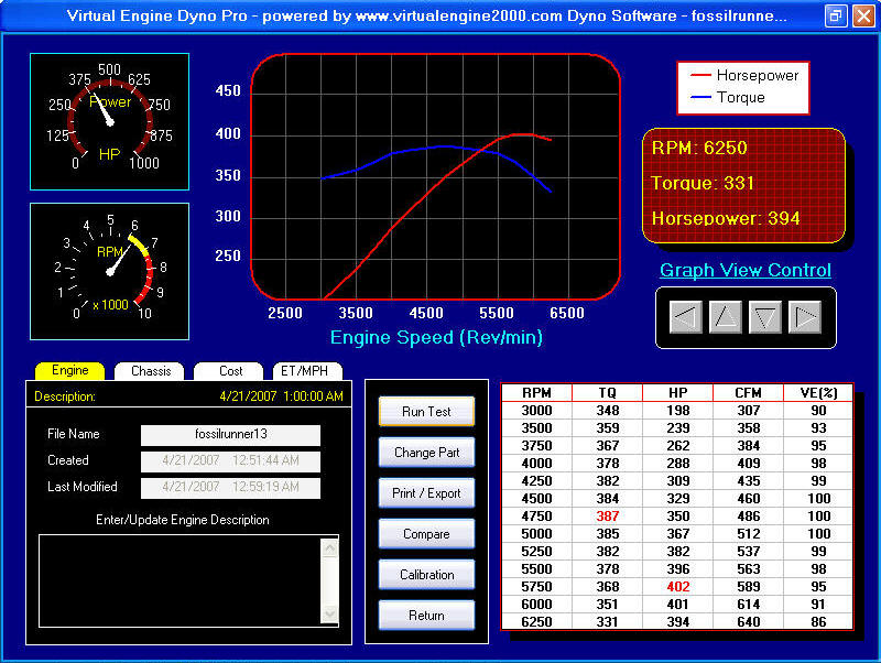

Thanks for the detailed info you provided, it makes running the computer dyno easy without having to look up anything. As mentioned earlier, you will see significant gains in the future if you upgrade your heads.
