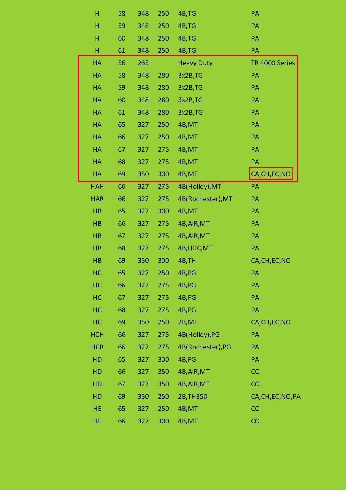

Need held with my 67 sbc ID code. The engine casting number is 3903352 and tells me its a 67/327. The question is the ID code T022I(eye)HA? I can't find anything that's a 67 with a code IHA. The heads are 3917291 if that helps. What engine do i have?

The engine assembly date will usually be four digits and the letter "I" was substituted for a "1" in some date codes. In your case, the engine assembly date is 02/21. The Lime Book" pages below explain this. You'll also note that "HA" code was only used in a Camaro (CA) in 1969. The only use in 1967 was in a full size Chevrolet (PA). Check the casting date on the block to determine what year the engine was built since this designation was used in multiple production years. The partial VIN on the block should also match the car's sequence number of the VIN if it's original to the car.

The block casting date is about a week before the assembly date, which should be in the proper time span. Without a partial VIN it's impossible to know if the engine is original to the car. According to the Lime Book, most of the 327 Camaro engines were in the area of ME through MN codes.
