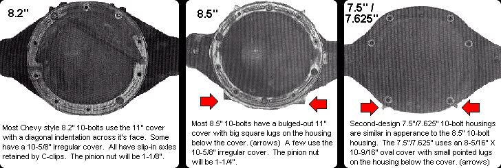

8.5 will have 2 triangle shaped lugs at bottom sides of casting, like this (post 7):
http://www.hotrodders.com/forum/rear...ing-82449.html
7.5 will have 2 pips in the same spot, but no way will you confuse a 7.5 for an 8.5.

67 didnt have a 7.5. plus the 7.5 cover is different
8.2 and 8.5 uses same cover.
8.5 will have 2 ears on the bottom of the pumpkin at about 5 and 7 o'clock
8.2 will not have them. they have a half circle kind of deal missing from them.
8.2 parts will fit in an 8.5 housing but not vise versa.
8.2 had 9/16" ring gear bolts with reg thread pattern, 8.5 had 5/8" bolts with reverse pattern.
hope this helps
