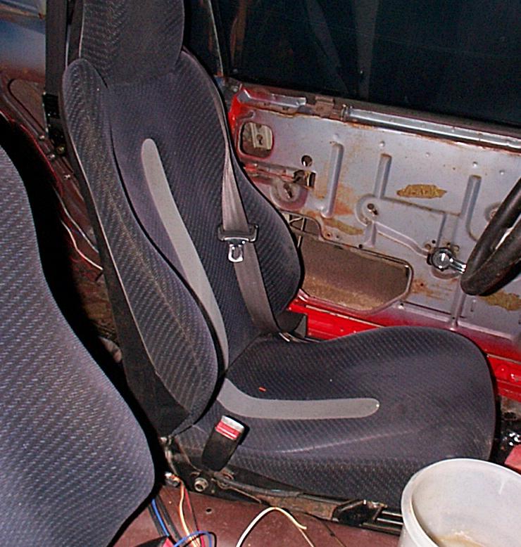

I got a set of seats out of a 92 Del-Sol. I made a steel square that bolted to the floor and then bolted to the seats. I also took the seat belts from the same car.
The inside portion of the seat belt (female side) is attached to the seat, so the tunnel bolt part is not needed. The outside portion I reused the factory mounting location. For the top loop (just holds the belt up basicaly) I used one of the 2 stock bolts. Then I had to make a metal frame that fits inside the rear area where the rear windows are. This is where the recoil mechinisim is (what the seat belt retracts into). I will need to get custom rear "door pannels" (or what ever they are called) made up, but I was planning on that anyway.
I have some better pics somewhere, but this may give you the idea:
http://www.1bad69.com/gallery/camaro...r/dcp01089.jpg
