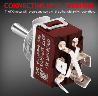

Why DPDT? I get why you’d need SPDT; what’s the second pole for?

​​​​​​​Why DPDT? I get why you’d need SPDT; what’s the second pole for?
From what I've gathered to switch the polarity. There are 4 wires, A positive and negative from the battery, and two wires running to the top motor. Here's a pic of the crossover - you would attach +/- to the center terminals and run the motor wires on the remaining two terminals.
