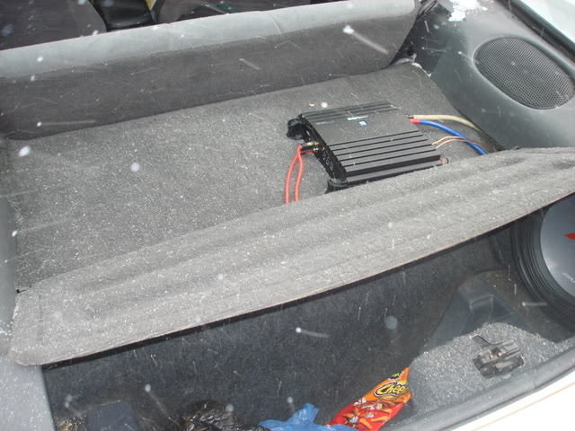

So here it is all put back together. I hadn't worked on it since the last pics I posted of the test fit. While I was doing my clutch I took it apart, used some strong wood glue, bradded it up, and put 5 coats of black krylon outdoor spray paint, then glued the carpet over the box.
It came out pretty good, but I have to cut the plastic that goes over it a little more so it fits a little better and not so tight.
I'm going to run the amp to the cubby hole opposite of the sub, I just need to reroute my power wire because coming from the p/s I don't have enough. I'm about 3 feet short. I'm going to run that under the carpet near the center console to give me the extra length I need. The sound is great.

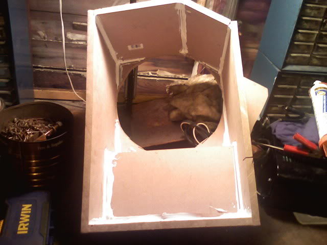

Looks good. I have a convertible so I am always looking for a better sound. If you can do you have the specs on how you built it?

No specs, you have to cut that plastic (if the vert even has it). Use cardboard to make the front shape, then build off the back. You'll have to measure as you go, you will need to build it down in the wheel well for the air space you're going to need. Glue it up, brad it tight, then epoxy the edges to ensure no air seeps out.
