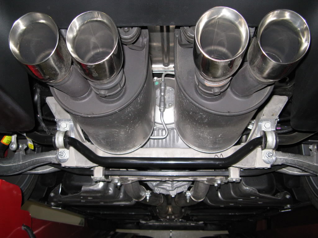

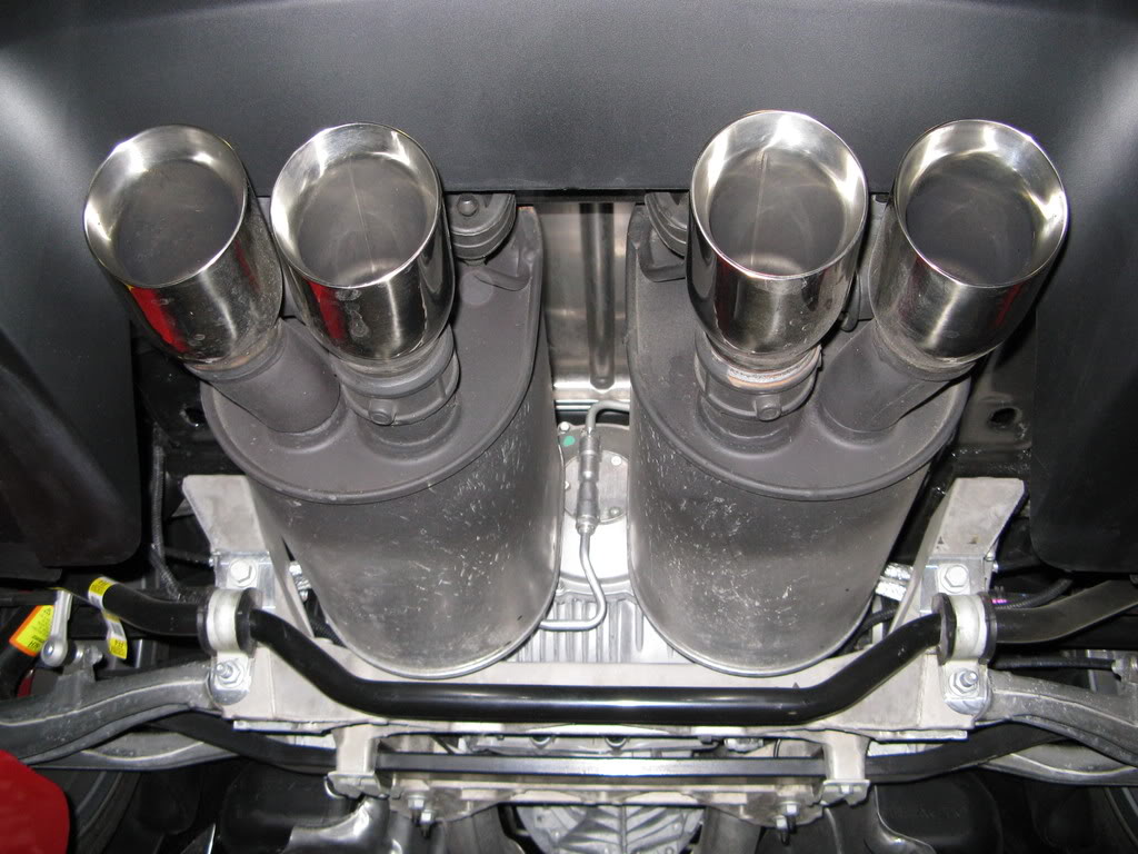

I would think that the use of the leaf spring would have an effect on the suspension, as its a large spring that ties both the left and right sides of the car together, making it a "semi-independant" suspension.
Having a coil over set up could give the car much better handling, at least I would think so.

wonder if they could just split it in the middle so the two "halfs" are separate?

While the leaf does span from left to right it is bolted twice once toward each side so that once side of the leaf spring behaves independently of the other. If it only bolted once in the center then you could get interference. The Corvette's transverse leaf spring is a great engineering solution. Smaller package, less weight, and it never wears out.
They've effectively done this by bolting each side to the outer edge of transaxle crossmember.
You can see it in this pic:
The horizontal grey bar beneath the sway bar is the leaf and you can see where it is bolted down.
Bit easier to see here:

its still one piece tho. i'm thinking two separate pieces might be better.
