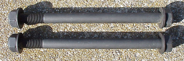

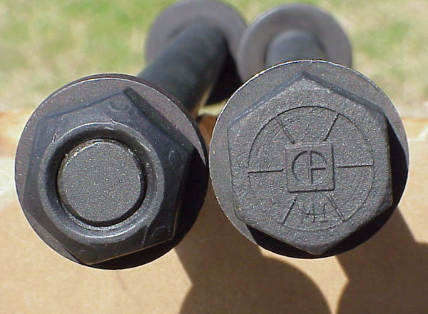

The rod bolts don't fit all the way through. I'm going to order these http://www.xse.com/leres/ss/images/catbolt1-sm.html. They are 9/16"x8" long. Caterpillar seems to be the only one that has them. I have a 12bolt and I don't hear the diff noise like you.

I also have a clunk with mine. The instructions say if you hear a clunking the end mount on the cross member needs greased. I greased teh living $&!% out of mine it still clunks. Trying to fix it on my to do list.
The link for the cat bolts is:
http://www.xse.com/leres/ss/images/catbolt1.jpg
and
http://www.xse.com/leres/ss/images/catbolt2.jpg
These are the two bolts that hold the mount to the rear axle housing.

The permissions are messed up on your image links.
Oh, found them. The first URL has a period stuck at the end, and the other 2 just dont seem to work. These do though:
http://www.xse.com/leres/ss/images/catbolt2-sm.html

Funny that you guys found the bolts on my torque arm page but missed the details on how I fixed my clunk:
I heard a clunking sound from the rear end when making the transition from forward to reverse, reverse to forward or hard braking to launching. This was because I had failed to tighten the bolts that hold the solid rod ends to the differential housing mount. It turns out there was a little gap between the rod ends and the plates. I made some shims from a sheet of stainless steel and now it's much easier for me to properly tighten these bolts.
The quick answer is make sure to tighen the bolts on the solid rod ends.
The reason the noise sounds like it's coming from the torque arm crossmember is because that's the only place it touches the the body; the noise is transmitted throught he arm.
The Caterpillar bolts are nice but I doubt the factory bolts are causing any clunking.
