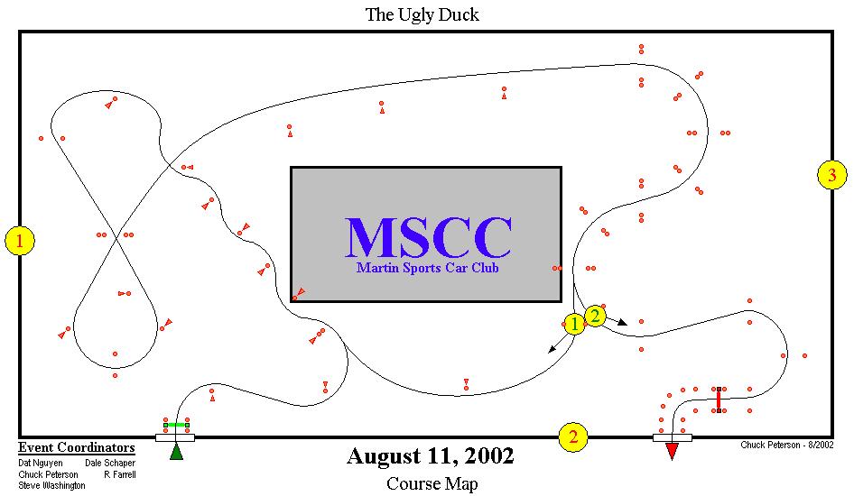

In the slalom section I've set the cones 32 feet apart. Is this enough? Is there a standard width? I measured it out in my driveway and it looked fine but the other guys that I'm working with this month thought it might be too tight.
Here is my course map btw.

The slaloms that I've paced off this year have all been a little longer, more like 40 - 45 ft. Wide enough that I haven't felt badly cramped even in my 108" WB Malibu
But you don't have to change the spacing to affect the way it drives, so you wouldn't have to redesign the whole course to open it up a little through the slalom. Just offset the cones a little to open the path through that section a little bit. Only a foot of clear track as you sight down the slalom will make a noticeable difference. Set it up in an empty lot and drive it yourself to see, first with zero offset gates, then open them up by 1'. You shouldn't have to do this it in full competition mode to get some idea of how it will drive on the day of the event. If it feels at all clumsy, needs a little too much steering lock, or wants 1st gear, then it's probably too tight. Remember that in competition you'll need more steering lock and will have less time to get it done. (If you then want to torture yourself a little, try it again with 1' of overlap.)

I cant see your map the link is not working for me. I would not worry. It would be worth pacing off though. If it feels just a little bit tight then tighten it up. Then add another slalom that is spread out more.
They are all diferent for a reason. Variety is the name of the game. Did you check out Roger Johnsons wright up on course design? It could be helpful.
Also dont sweat it everyone will have a good time.

I say start em at 50 ft for the first 2, then end with 35 ft
4 back and fourth motions...You can go into it hot and maybe you'll see more "tail-waggage" aye?
Fun for the crowd and it'll keep everyone on thier toes after the first run!!

Good point about the offset. I'll keep that in mind. I also think I'll set up a 32' wide slalom on a back road by my house and try it out tomorrow.

SCCA minimum is 45 feet between slalom cones, or a manuver that could be considered a slalom. You'd never make 35 foot slalom cones unless you were crawling, and nobody would be at all happy about it.
I'd recommend a minimum slalom spacing of 50 feet. I used 53 feet in one of my slaloms this year at the Oscoda, MI ProSolo, and it was not liked by all. But I like to make people think, it was after a 300 foot start straight too!
I can't access the map, so I can't help you on the design aspect.
However, most use too many cones. You don't need gates every 10 feet. Don't be afraid to use pointer cones. Wide gate widths are good too, it lets you pick a line. 15 foot gates are way too tight (and SCCA minimum, maybe 18 now). Mine are usually at least 20, and usually more like 25....

There's a good link for Solo II Course Design at
http://www.ghg.net/cmjfsl/
I can't remember if it's by Roger Johnson or not. North American Pylon ran a few blurbs from it a few months ago.
Most of the slaloms I prefer end up being 15-20 paces from cone to cone. I would assume that is 45-60 ft. That would be a good 2nd gear slalom for most of us I think. I hate being stuck in 1st gear for long.
