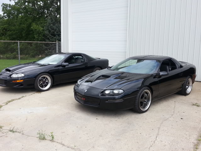

What Vance said....completely closed mine off on my '01 and the 460 cools itself juuuust fine.
Me on the right....
