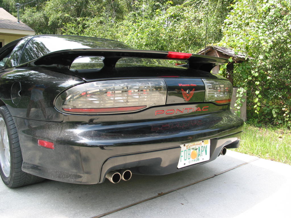

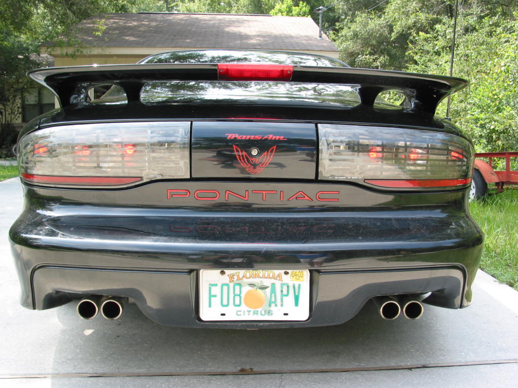

Here are pics of my bud's clear Trans Am tail lights with LEDs...
http://www.bfranker.badz28.com/misc/cleartails01.JPG
http://www.bfranker.badz28.com/misc/cleartails02.JPG
http://www.bfranker.badz28.com/misc/cleartails03.JPG
http://www.bfranker.badz28.com/misc/cleartails04.JPG
http://www.bfranker.badz28.com/misc/cleartails05.JPG
