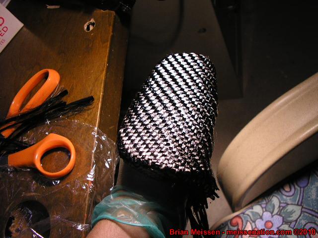

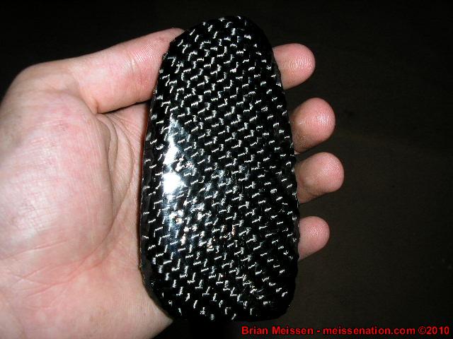

It's not 100% perfect, but for being my first try at it, I'm really happy how it looks.

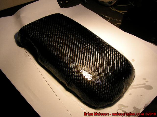

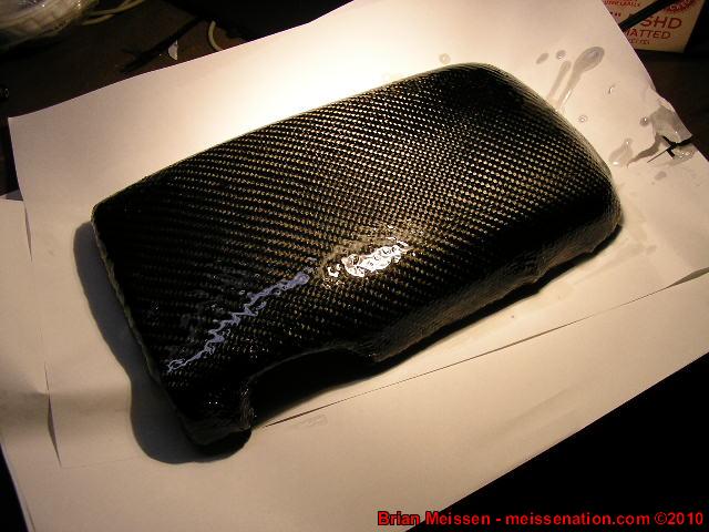

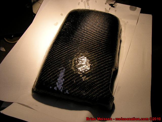

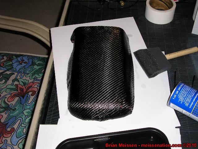

haha well it's carbon fiber twill, I actually purchased all materials off ebay... carbon fiber twill 50" by 48" and then also a gallon of clear laminating resin (w/ hardener). You take the piece you want to cover, sand it down to scuff it up, spray some spray adhesive onto the piece, let the adhesive get tacky, lay the carbon fiber onto the piece (giving a good 2-3 inches extra on each side, so you can grip it and wrap it and what not), let the glue dry a little, make up some resin, put the resin on so the resin soaks through the carbon fiber and into the plastic... let the first layer dry, then do another layer, let dry, another layer, wet sand (I purchased 1000, 1500, and 2000) progressively from 1000 grit to about 2000 grit, and then paint with clear coat automotive paint. I'm on the final layer of the resin stage, and then I have to sand and install.

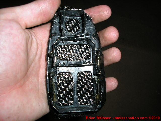

I still don't know wtf you are carbon fibering... . How can a console lid fit in the palm of your hand?
The third picture looks like the console lid........but the fourth picture I'm still not sure of.

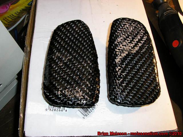

hes doing the console lid and the window switches. looks great man.
