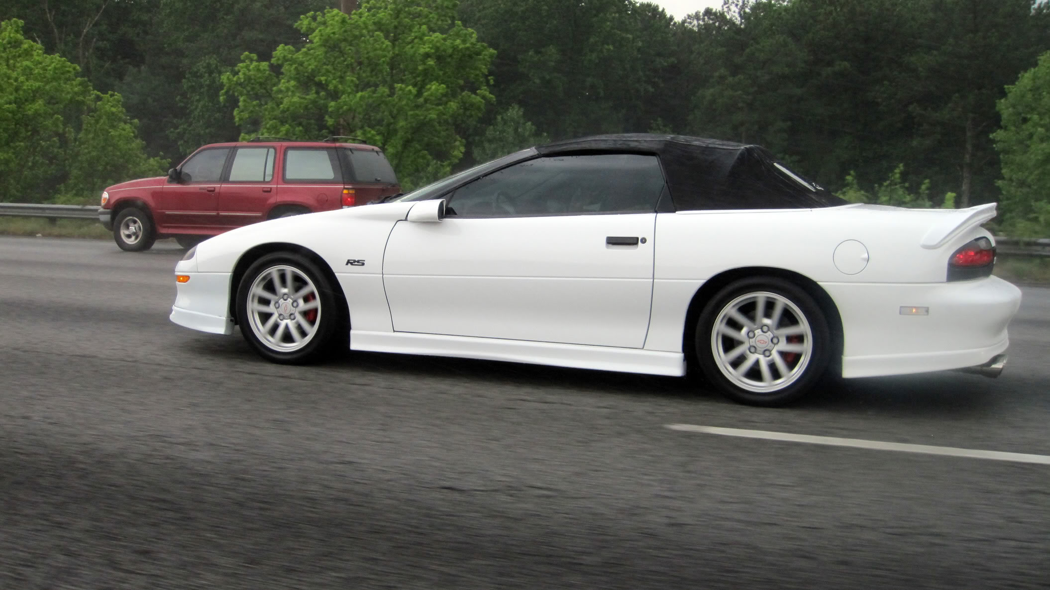

Well what does it look like with them removed? And is it hard to get them off?

Well how did you get them off?

I would recommend a hair dryer to loosen up the adhesive and then some dental floss behind the trim to pull it off. You can use a heat gun but be careful you don't over heat it and bubble the paint.
