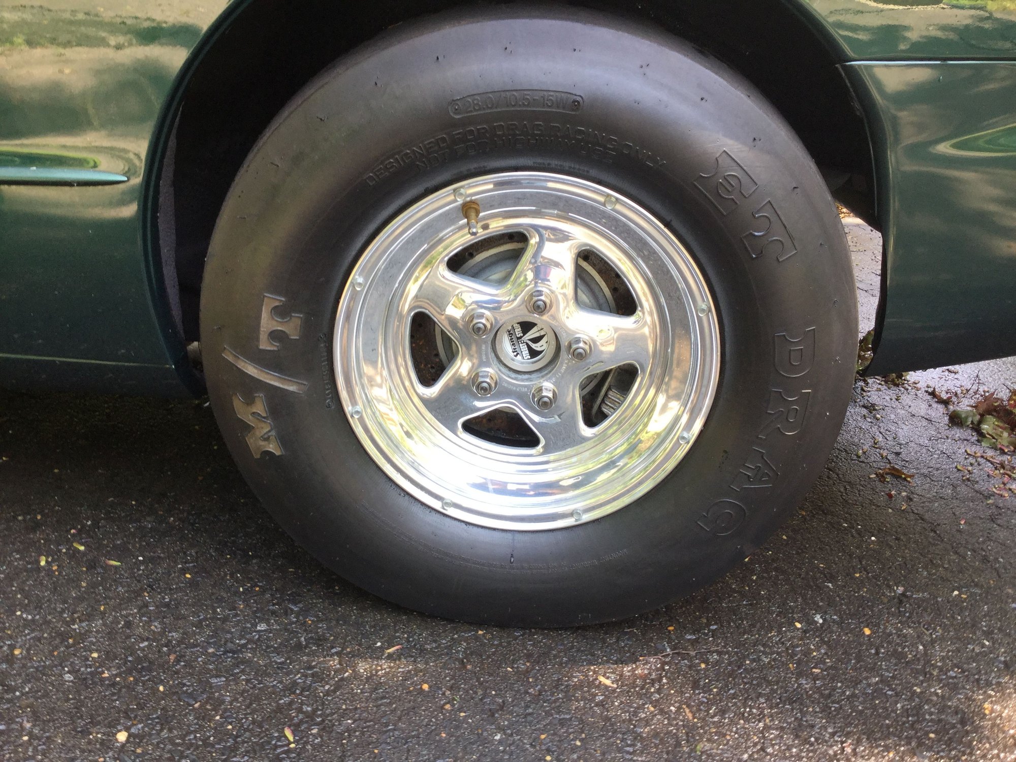

Here's a photo of my 94 Formula rear wheel taken a few months ago, just before I sold it. The caliper peaking through the wheel spokes is the original aluminum caliper that was on the car when I bought it brand new 27-1/2 years ago. The car has sat outside for about the last 3 years. No sign of corrosion. The rotor is a Baer aftermarket that has been on the car for about 22 years. It has a “zinc-washed” finish that has prevented corrosion of all surfaces except the swept surface.
Would that appearance meet your needs? You be the judge.
