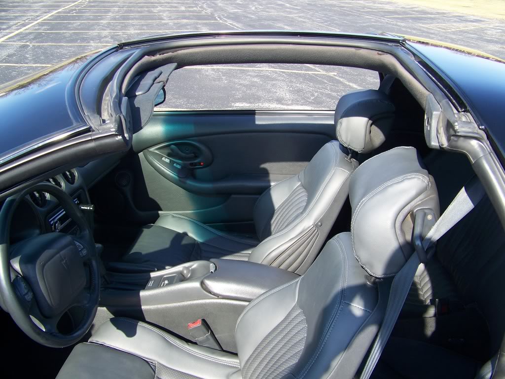

I think most people's t tops leak because they never take the time to properly adjust them. To get to the mounting brackets you have to remove the headliner which can be a PITA since they are very frail and break very easily. I really dont understand where they could possible leak from either, unless the glass was not touching the weather stripping all the way (assuming the weather stripping was in good condition).

Great looking job so far Derrick! Man, you got some ***** to take that saw to the car for the first cut! Dunno if I could do that..
Keep the pics coming!

for that kind of money you should just get one of the ABS plastic ones which are around $200 i think. i made the mistake of trying to recover mine a few years ago and i think it cost me around $160 and while it looks pretty good, its not perfect. my original board broke during the process and i had to get a new one. luckily i had enough material from year one to recover 2 boards, but the glue was pricey too. so $60 for the material, $40 for the used board and $60 in glue (the glue was $15 per can and it took 2 cans each time it was done) so total cost was ~ $160 not counting a 100 mile round trip down to miami to get the used board from trans am creations. hindsight is 20/20 but if i could go back and do it all over again i would have just gotten one of the ABS plastic ones covered in graphite.
you can see where it doesn't wrap around the corner perfecty on the back side of the headliner in the first pic and in the second pic you can see where the faboric didn't completely cover the board in one spot.

Yeah I am planning on buying a plastic one, but its really not bothering me right now. Hell, I might just leave the headliner out.
