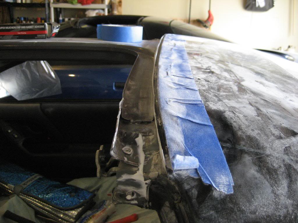

Prepping the car for fiberglass/bondo/paint
Notice the white face gauges (I still need to take and post pics of this install)
Fiberglass:
Well, those are all the pics I have so far. I still haven't completely finished the project, I need a new headliner and I still need to get everything cleaned up, the weather just hasnt been cooperating (I hate IL).
