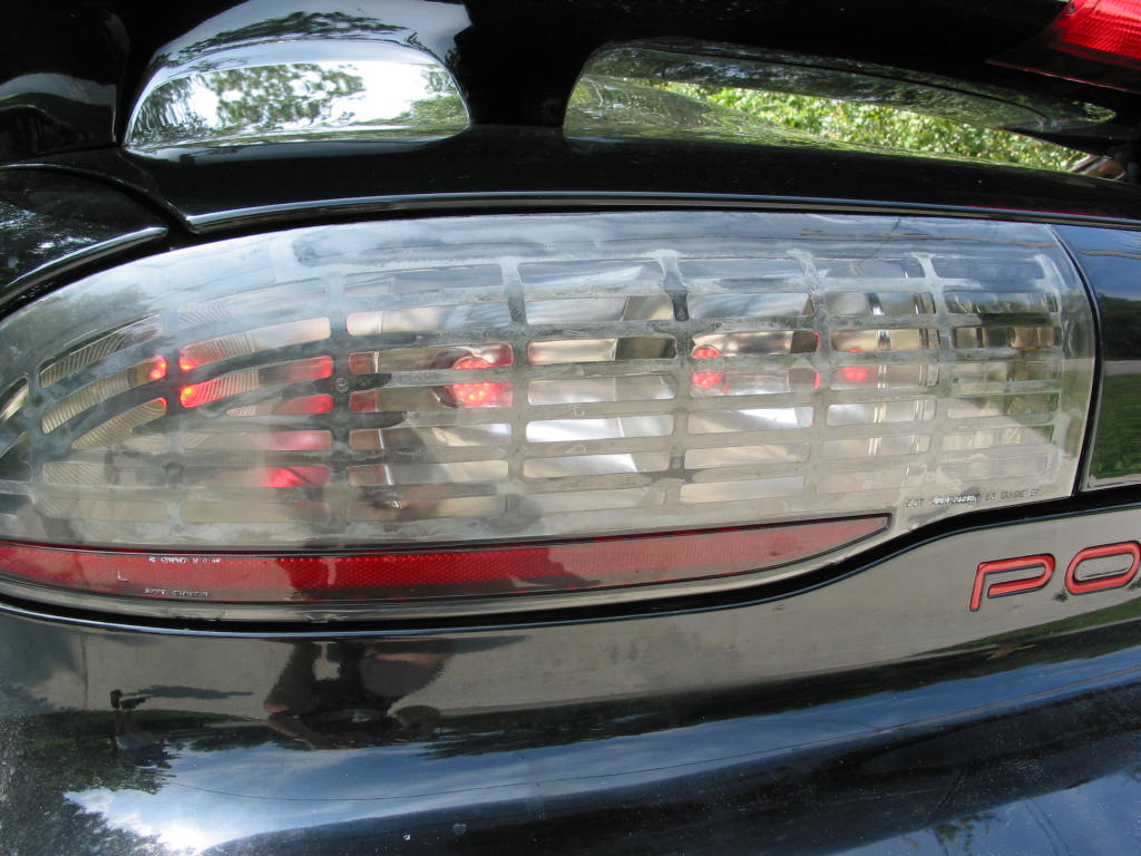

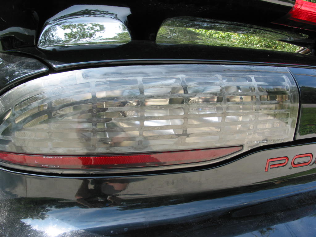

These LEDs were purchased at AutoZone.
http://www.bfranker.badz28.com/misc/cleartails04.JPG
http://www.bfranker.badz28.com/misc/cleartails05.JPG
The corner bulb was changed to a larger style bulb by using the directions below to make the hole larger.
http://www.bfranker.badz28.com/fbody/sequentialTA.htm

I would say they are bright enough. I have followed that car and while they aren't as bright as the regular bulbs, they will get your attention.
These require a special electronic flasher.
