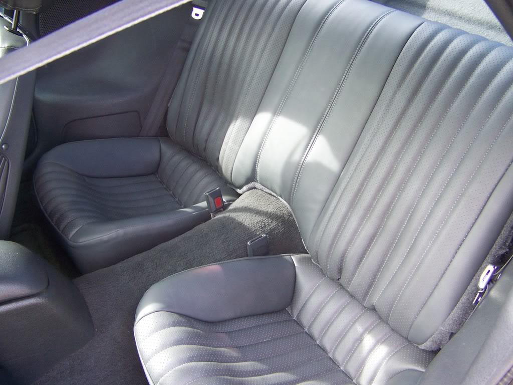

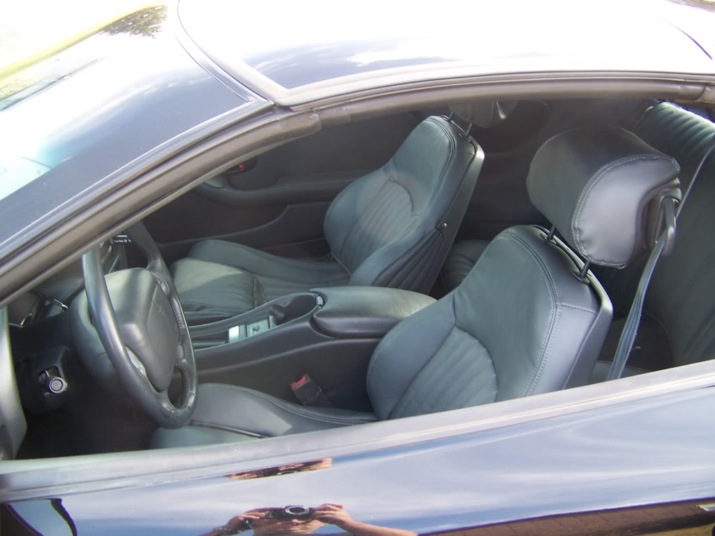

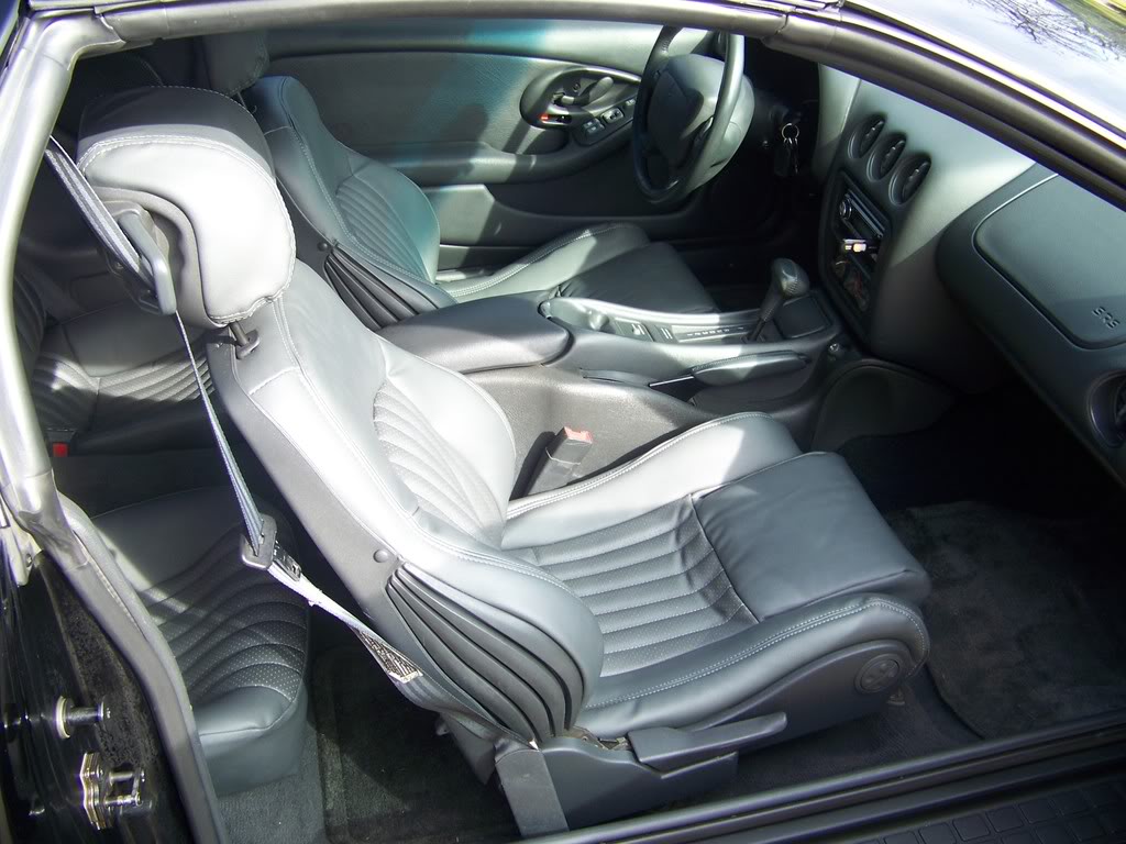

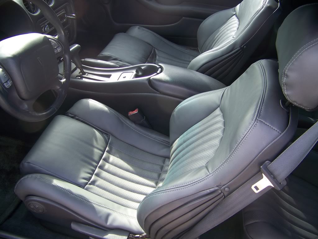

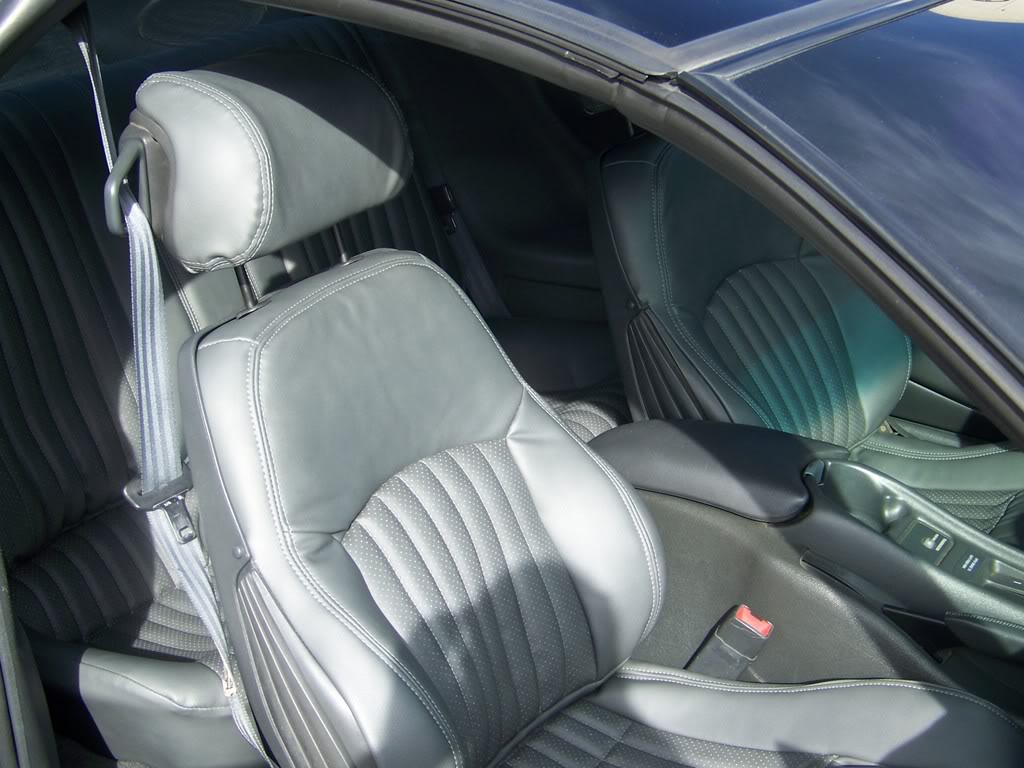

FWIW the T/A seat covers are harder to install than the camaro. the rears are the same but the front top portions don't just slide down like the camaro do, you have to hogring them down and there is sewing involved to get the accordian pieces in place. i paid a shop $450 to do my front seats. all told i spent around $850-$900 having mine done with buying the hawks kit.

Old Nov 13, 2009 | 04:56 PM
ReaperWS6's Avatar
Joined: Oct 2009
Posts: 79
From: Toronto, Canada
Those look mint! I'll be doing the same thing once I get my set from my buddies '91 Formula.
